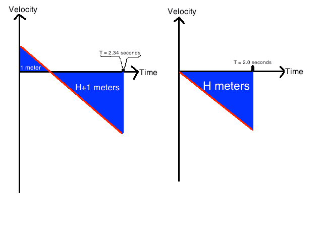

An astronaut on PLANET OSKI is standing on a cliff of unknown height H. The astronaut would like to ascertain the gravitational acceleration g0 of PLANET OSKI. In order to determine H and g0, the astronaut performs two experiments:
1) FIrst she leans over the edge of the cliff and drops a rock. She notes that it takes approximately T1 = 2.0 s for the rock to land on the surface below.
2) Next, she leans over the edge of the cliff and tosses a second rock straight upwards. The rock rises for approximately h = 1.0 m, then falls to the ground below. A time T2 = 2.34 s elapses between the moment the rock leaves her hand and the moment the rock strikes the ground.
Find H and g0. (Assume that air resistance is negligible.)

I tried solving this three times. On the first and third tries, I failed to eliminate any variables. On the second try, I got g = 1.309 m/s and H = 2g, but this does not satisfy the astronaut's second experiment of being only 2.34 seconds long. Algebra problems with many variables like this are very time consuming and I don't have a good strategy for solving them. I spent two hours trying to tackle this problem! For this question, I would simply plug in as many known values as I am given into the equations. Then, I would start manipulating them while praying that I would somehow end up with an equation with only one variable. Is there a good strategy for this? All suggestions are welcome.
Any time you blindly plug numbers into a formula, you are setting yourself up for mistakes. What if you had no answer sheet (like the astronaut)? You should still be able to come up with an answer that you have confidence in. In my opinion, the "kinematics equations" are entirely useless and can cause more trouble than they're worth. The only kinematics equations you need to know are [itex]v=\frac{dx}{dt}[/itex] and [itex]a=\frac{dv}{dt}=\frac{d^2x}{dt^2}[/itex]
All of the information in the problem is summarized in this picture:
All you need to know is that the slope of the graph is g0. (And how to find the area of a triangle.)
Now write a few equations describing the area of each triangle.

Thank you for your suggestion, here is what I got:
Area of a triangle is (1/2)LW, so when she drops the rock it's H = 0.5 * 2 * Vf.
When she throws the rock it is H+1 = 0.5 * (Time need to fall H + 1 meters) * Vf. This final velocity is different from the case where the rock falls.
I also know that the line for the two graphs is y = mx + b. So it's y = -gt (where t = x axis) for the falling rock and y = -gt + V0.
Where should I go from here?

Now write Vf in terms of g. This gives you one constraint on H and g (the other constraint comes from the other graph).
Right, so now write this final velocity in terms of g and V0
Also, break up the 2.34 second interval into two times, T1 and T2, such that T1 is the time from when the rock is released to when it has zero velocity. Then T2 will be the time from when it has zero velocity (at it's max height) to the time when it hits the ground. Then write an equation for the remaining triangle (the one with area 1 meter).
Nathanael said:
Now write Vf in terms of g. This gives you one constraint on H and g (the other constraint comes from the other graph).Right, so now write this final velocity in terms of g and V0
I get H = 0.5 * 2 * gt --> H = 2g
For the thrown rock, I get Vf = V0 + gt --> Vf = g(2.34). This is the interval from max height to ground.
The other triangle has area = 1 = 0.5(Time to reach max height of 1 meter)V0

I'm not sure why you dropped the V0, it's not zero. (Perhaps just a typo?) It should be Vf=V0-2.34g (g is negative because the slope is negative)
This comes from the definition of slope, [itex]\frac{Δy}{Δx}=-g[/itex] therefore [itex]Δy=-gΔx[/itex]
(g is only negative because it's sloping downwards, that is, a positive change in x gives a negative change in y)
In this case, y is velocity and x is time, so slope is actually [itex]\frac{Δv}{Δt}[/itex] (which of course has units of acceleration)

Right. I prefer to call it T1 and T2 (it's easier to read). Do you know any relationship between T1 and T2? That's the final key and then it's just algebra. (You can then eliminate V0 from the two equations for the 1 meter triangle and the (H+1) meter triangle.)

Doing it this way is equivalent to using the "kinematics equations." I just wanted you to do it this way because you said you felt like you were blindly manipulating equations.
(Plus, I never memorized any "kinematics equations" so I prefer to solve the problem visually. You can derive every single "kinematics equation" from triangles like this, so if you understand the visual approach, then there's no need to memorize anything!)

Why isn't V0 zero? In your last post, you wrote that Vf=V0-2.34g. If Vf = the velocity at 2.34 seconds, shouldn't the initial velocity be zero because the rock is at its maximum height. On the other hand, if we take Vf to be the velocity at the maximum height, then V0 = nonzero and Vf = zero. Correct me if I'm wrong but it seems that it's not possible to have both Vf and V0 in the same equation...
You could use your equation where V0 is zero (at the maximum height) but then you would not want to use the full 2.34 seconds! You would just want to use T2 (so it would be Vf=T2g)
(I hope this explains the confusion.)
I'm thinking it might be a little algebraically easier later if you use the full 2.34 seconds and the initial velocity.
(But I haven't gone through any of the algebra myself so I could be dead wrong about that.)
