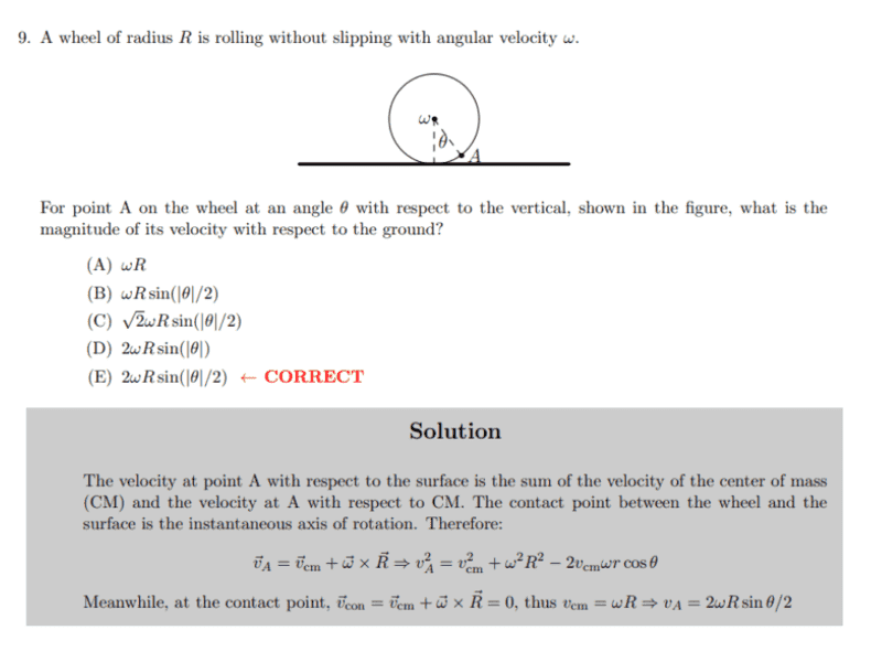

Given an angle for the what is the tangential velocity, A, respecting the ground.
v_a = v_cm + w x R
Center of mass velocity in respects to the ground + tangential velocity of a in respects to the center of mass velocity = A in respects to the ground
I don't understand the extra - in the second part of the equation, before the 2.
From my understanding, the squaring of the first part of the first equation is so that the equations consist of magnitudes. I'm just not quite sure where the negative came from. If I had to guess, it would be, w, harboring the negative (because it's pointing into the page)???
Thank you in advance!
Try writing the three vectors, ##\vec v_{cm}, \vec\omega, \vec R##, in ##\hat i, \hat j, \hat k## notation and performing the multiplications.

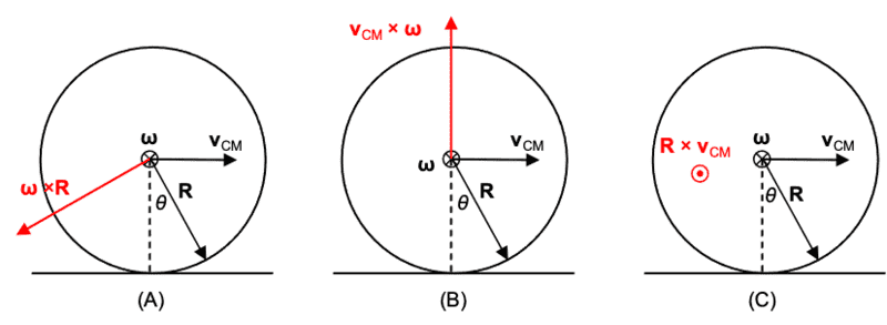

$$\vec v_A\cdot \vec v_A=(\vec v_{cm}+\vec \omega\times \vec R)\cdot (\vec v_{cm}+\vec \omega\times \vec R)=v_{cm}^2+\omega^2R^2+2~\vec v_{cm}\cdot(\vec \omega\times \vec R).$$The first two terms are easy to see where they come from. Consider now the cyclic invariance $$\vec v_{cm}\cdot(\vec \omega\times \vec R)=\vec R \cdot(\vec v_{cm}\times \vec\omega)=\vec \omega \cdot(\vec R\times \vec v_{cm}).$$One of these three terms (which one?) gives you a vector cross product that is in the plane of the wheel. Draw it and see what you get when you dot it with the third vector.

Consider the cross term and its two cyclic equivalents $$\vec v_{cm}\cdot(\vec \omega\times \vec R)=\vec R \cdot(\vec v_{cm}\times \vec\omega)=\vec \omega \cdot(\vec R\times \vec v_{cm}).$$ In cases (A) and (B) in the figure below, the angle between the vectors to be dotted is greater than ##\frac{\pi}{2}## so the dot product is negative. In case (C) the vectors to be dotted are antiparallel. Cases (B) and (C) are easier than (A) for finding the entire term using ##\vec A\cdot \vec B=|\vec A||\vec B|\cos\theta## because the cross product involved is along one of the principal axes. The derivations are shown below the figure.
Case (B) ##[\vec R \cdot(\vec v_{cm}\times \vec\omega)##]
##|\vec v_{cm}\times \vec\omega|=v_{cm}~\omega## so that ##\vec R \cdot(\vec v_{cm}\times \vec\omega)=R~v_{cm}~\omega~\cos(\pi-\theta)=-\omega R v_{cm} \cos\theta.##
Case (C) ##[\vec \omega \cdot(\vec R\times \vec v_{cm})]##
##|\vec R\times \vec v_{cm}|=v_{cm}R\sin(\frac{\pi}{2}-\theta)=v_{cm}R\cos\theta.## The direction of this cross product is ##-(\hat {\omega})## so that ##\vec \omega \cdot(\vec R\times \vec v_{cm})=-\omega R v_{cm} \cos\theta.##

If it's only a question of sign, then I think diagram (C) is the best way to figure it out. It shows that the sign is positive/negative if ##\vec R## is above/below that horizontal.
