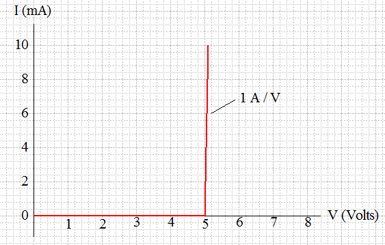

Okay. You've noted that the zener operates with a reverse bias. That's where the "Zener" breakdown occurs. That also means that the area of interest for the zener's characteristic curve is in the third quadrant, where both the component's voltage and current are negative.
To make using the curve more convenient you can rotate it and use treat the current and voltage as positive values. So for the curve you've shown, where the breakdown occurs with a reverse bias of 5 V, the region of interest for the rotated curve will look something like this:

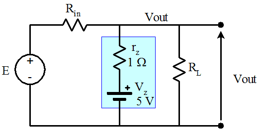

You can also model the zener as an ideal zener in series with a resistor ...
Would you be so kind to draw me a simple schematic? Would you have the cathode of the ideal zener pointing up or down? What would the voltage and resistance be?
I understand if you don't have the time but would be helpful.
gneill said:
The Thevenin model would include the Rin and RL. The load line takes the open circuit voltage and short circuit current of the Thevenin equivalent as its end points. So work with the Thevenin equivalent.
Does the Diode factor into the Thevenin equivalent circuit?
The ideal zener just provides the inflection points in the characteristic curve (the forward bias turn-on and reverse bias zener turn-on points). Look at the characteristic curve of your zener. Everything you need to know is there.
Also note that as long as the zener is operating in "zener mode" you can model it as a voltage source in series with a resistor. If it might drop out of zener mode and turn off you can include an ideal diode in the path to accomplish that:
If there's a risk of the zener becoming forward biased, include another diode in parallel to handle that eventuality.

Okay, so the load line appears to be from (0,10) to (6.33,0). Thus it crosses the iv line of xener diode slightly past 5 Volts. I don't have any easy way to draw the line to scale. Looked online but didn't find any apps that let me do it.
How did you determine the (0,10) point? What are the units, and is it really exactly 10?
You should be able to sketch it out by hand, and I'll assume that you can do that since you've got the idea that the load line crosses the zener's curve where it is conducting, and so is just a shade over 5 V. The important thing about the graphical method is that you can verify which part of the zener's IV curve is involved.
If you're satisfied that you can find the operating point graphically, we can tackle a method for finding it mathematically, too.
I divided the Voc by the Rth and figured that would be the Isc. I believe I can get the operating point graphically, and would be interested in how to do it mathematically.
Also, now that I have the operating point, how do I found Vo and vo?
And the units I used were milliAmps
Voc is the same as Vth which is (in this case) about 6.33 V. Rth is 666.6 Ω. That makes Vth/Rth 9.5 x 10-3 A, or 9.5 mA, right?

What's going to comprise your zener model?
  • #31
For the zener model, I would guess a 5 V source and a 1 ohm resistor? With the + end of the source pointing up
  • #32
Yes. Very good.
  • #33
Great, I will try the equations and post my results. Thanks again for all your patience.
  • #34
So far, I came up with the following equation for KCL:
$$\frac{ (E - Vz)} {Rin} = Iz + \frac {Vz} {RL}$$
  • #35
Usually the variable name Vz is reserved for the zener threshold voltage (which is 5 V in this case). Maybe you want to name the node voltage something else. Vout perhaps? If you've replaced the zener with its equivalent model then you should just have resistors and voltage supplies to deal with. That is, you can write an expression for Iz in terms of E and Vz (given that Vz is the zener threshold voltage).
You can plug in the values for the fixed components Rin, RL, rz, Vz. You'll be left with Vout in terms of E.
