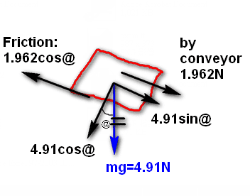

mchei

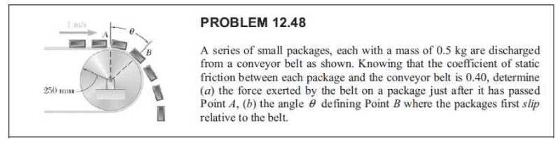

define RHS as +ve
in a part, i have calculared that force by conveyor is +1.962N
in b part,
then, to balance force, 4.91sin@+1.962=1.962cos@ => @=-43.6'
i an confused about the negative sign... what is my problem?
Your free body diagram is missing a normal force due to the belt
that's true, thx
