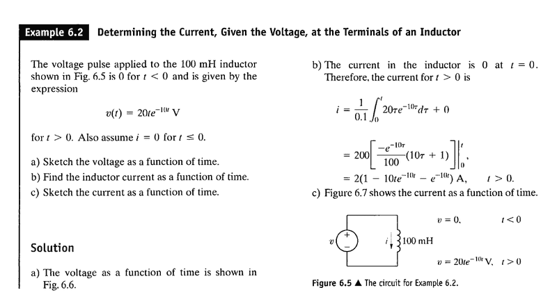

I know ∫(xe[itex]^{ax}[/itex]) dx = x (e[itex]^{ax}[/itex] / a) - (1/a) ∫e[itex]^{ax}[/itex] . 1 dx = x (e[itex]^{ax}[/itex] / a) - (1/a) (e[itex]^{ax}[/itex] / a)
= (e[itex]^{ax}[/itex] / a) (x - 1/a)
i.e, integral of two functions = (first function) (integral of second function) - ∫(integral of second function) (differential of first function)
This is not a homework. I am a working professional and I need help in solving a problem.
The solution I need is for
(1/0.1) ∫20te[itex]^{-10t}[/itex] dt between limits 0 and 20 us. limits can be taken as 0 to t. I don't need numerical solution.
t = [itex]\tau[/itex]
dt = d[itex]\tau[/itex]
integral becomes
200 ∫[itex]\tau[/itex]e[itex]^{-10\tau}[/itex] d[itex]\tau[/itex] between limits 0 and t
it becomes 200 [ [itex]\tau[/itex] (e[itex]^{-10\tau}[/itex] / - 10) + (1/10) ∫e[itex]^{-10\tau} [/itex] . 1 d[itex]\tau[/itex]
= 200 [ [itex]\tau[/itex] (e[itex]^{-10\tau}[/itex] / - 10) + (1/10) (e[itex]^{-10\tau}[/itex] / - 10)]
= 200 [ [itex]\tau[/itex] (e[itex]^{-10\tau}[/itex] / - 10) - (1/100) e[itex]^{-10\tau}[/itex]]I know I have to apply limits to the two e[itex]^{-10\tau}[/itex]
I want to know should I apply limits also to [itex]\tau[/itex] which is at the beginning of the solution (here... = 200 [ [itex]\tau[/itex] ...) ?
So you have the indefinite integral
$$\int \tau e^{-10 \tau} \, d\tau = - \tau e^{-10\tau} / 10 - e^{-10\tau} / 100 = -\frac{e^{-10\tau}}{10} \left( \tau - \frac{1}{10} \right)$$
which looks correct to me (I've rewritten it slightly to look a bit better).
Now evaluate that expression at ##\tau = t##, and at ##\tau = 0##, and subtract the result.
Yes, everywhere there is a τ, you must substitute the limits.

So the limits are applied to whole solution and not just the integrals. Right? i.e., Even though [itex]\tau[/itex] is not integrated or differentiated in the process.
Edit: CompuChip I think you made a mistake.
Is it not
-e[itex]^{-10\tau}[/itex] / 10 ([itex]\tau[/itex] + 1/10)
I get ([itex]\tau[/itex] + 1/10) in the brackets
yours is ([itex]\tau[/itex] - 1/10)
You made a mistake in the sign?I was referring the book "Electric Circuits 9th edition by Nilsson and Riedel" page no 178.

Yes, you are right. Good catch!
I mean, of course I was just checking if you were paying attention.
