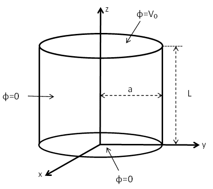

The potential on the side and the bottom of the cylinder is zero, while the top has a potential V_0. We want to find the potential outside the cylinder.
Can I use the same boundary conditions as for case of inside cylinder potential?

The general solution for potential outside the cylinder is than
[tex]\Phi(\rho>a, \varphi, z)=\sum_{m=0}^{\infty}\sum_{n=1}^{\infty}\big(J_{m}(k_{mn}\rho)+N_{m}(k_{mn}\rho)\big)\sinh(k_{mn}z)[A_{mn}\sin(m\varphi)+B_{mn}\cos(m\varphi)].[/tex]
Is there sin hyp function in z dependence part?
Or must we split function on two part, for z>L and z<L and use exp function for z-dependent part? Because hyp functions don't vanish when z goes to infinity.
[tex]\Phi(\rho>a, \varphi, z>L)=\sum_{m=0}^{\infty}\sum_{n=1}^{\infty}\big(J_{m}(k_{mn}\rho)+N_{m}(k_{mn}\rho)\big)\mathrm{e}^{-k_{mn}z}[A_{mn}\sin(m\varphi)+B_{mn}\cos(m\varphi)][/tex]
[tex]\Phi(\rho>a, \varphi, z<L)=\sum_{m=0}^{\infty}\sum_{n=1}^{\infty}\big(J_{m}(k_{mn}\rho)+N_{m}(k_{mn}\rho)\big)\mathrm{e}^{k_{mn}z}[C_{mn}\sin(m\varphi)+D_{mn}\cos(m\varphi)][/tex]
What is the right way?
There is a sketch for a better illustration:

His cylinder is finite and part of the z axis is contained in the outside as well. His boundary conditions are specified on the full cylinder surface and there is no need to add further conditions. There is in general going to be a surface charge in order to fulfill the given boundary conditions, so the potential may not be differentiable on the surface.
Furthermore I suspect this problem will not admit a simple series solution since the outside of the cylinder is a relatively nasty space to work in. The eigenfunctions are going to be fairly nasty and you will probably have to patch solutions in different parts of space with corresponding solutions to match the boundaries.
