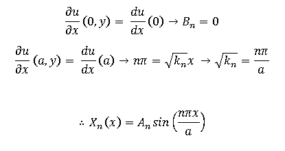

The equation is Uxx + Uyy = 0
And domain of solution is 0 < x < a, 0 < y < b
Boundary conditions:
Ux(0,y) = Ux(a,y) = 0
U(x,0) = 1
U(x,b) = 2
What I've done is that I did separation of variables:

X''/X = -Y''/Y = k
For case k > 0, I saw that it gives no non-trivial solutions.
For case k = 0, I solved it and found U(x,y) = y/b + 1
For case k < 0, I'm slightly lost.
X'' + kX = 0
Y'' - kX = 0
Using the X boundary conditions:

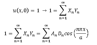

Using the Y boundary condition:
Using Fourier Series to find the coefficient:
But the integral just gives Dn = 0, and this doesn't satisfy u(x,0) = 1.
Can someone explain where I went wrong?
Thanks!

Your working is confusing.
If you start with [itex]X'' = kX[/itex] and want [itex]k < 0[/itex], you should then be writing [itex]\sin(\sqrt{|k|}x)[/itex] and so forth, or defining [itex]k = -c^2[/itex] where [itex]c \geq 0[/itex].
You want to be using cosines, which in fact you end up doing, but only after expressly stating that [itex]X_n = A_n\sin(n\pi x/a)[/itex].
Now the cosine expansion of [itex]1[/itex] on [itex][0,a][/itex] is [itex]\cos(0x)[/itex]. Thus you have correctly determined that all the other coefficients vanish.
