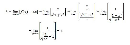

Hello,
I have a problem with the attached limit. The problem is, that according to my calculations when x -> infinity, the limit is 1, which is fine, but what happens when x --> - infinity... ?
x is squared, so I think it should not matter, and the limit should remain 1, however, the correct answer is -1, and I just don't understand why or what I did wrong in my solution. An assistance will be appreciated !

Interesting question :) This isn't a rigorous argument but I think it should be sufficient.
I think it has to do with moving a variable in and out of the square root. $x \ne \sqrt{x^2}$ if $x<0$.
Take a look at \(\displaystyle \sqrt{x^2+1}\). Another way to manipulate this algebraically is to simply factor out an $x^2$ term like so:
\(\displaystyle \sqrt{x^2 \left(1+ \frac{1}{x^2} \right)}=\sqrt{x^2} \sqrt{\left(1+ \frac{1}{x^2} \right)}\).
When simplifying $\sqrt{x^2}$ it's best to be careful and write it as $|x|$, which is what I think is appropriate now.
As before the limit of the \(\displaystyle 1+\frac{1}{x^2}\) part tends to 1, so what's remaining is \(\displaystyle \frac{x}{|x|}\). Since x is on the negative side of the number line in order to drop the absolute value bars we add a negative sign. That leaves us with \(\displaystyle \frac{x}{|x|}=\frac{x}{-x}=-1\), where $x<0$.
beware the square (it's not a 1-1 operation)!
not just being silly...
at one point you square x, and put it under the radical.
well, squaring a negative number ALWAYS gives you a positive number, so you've just changed the sign of your expression without realizing it.

Now I understand my mistake...thanks !
