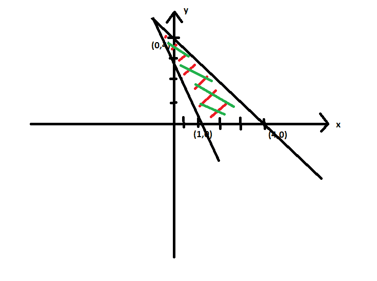

The following linear programming problem is given and I want to solve it graphically.
$$\max (x-y) \\ x+y \leq 4 \\ 2x-y \geq 2 \\ x,y \geq 0$$
I have drawed the lines :
$$(\ell_1) x+y=4 \\ (\ell_2) 2x-y=2 \\ (\ell_3) x=0 \\ (\ell_4) y=0$$
as follows:
View attachment 5092I have drawed the line $2x-y=0$ taking into consideration the following:

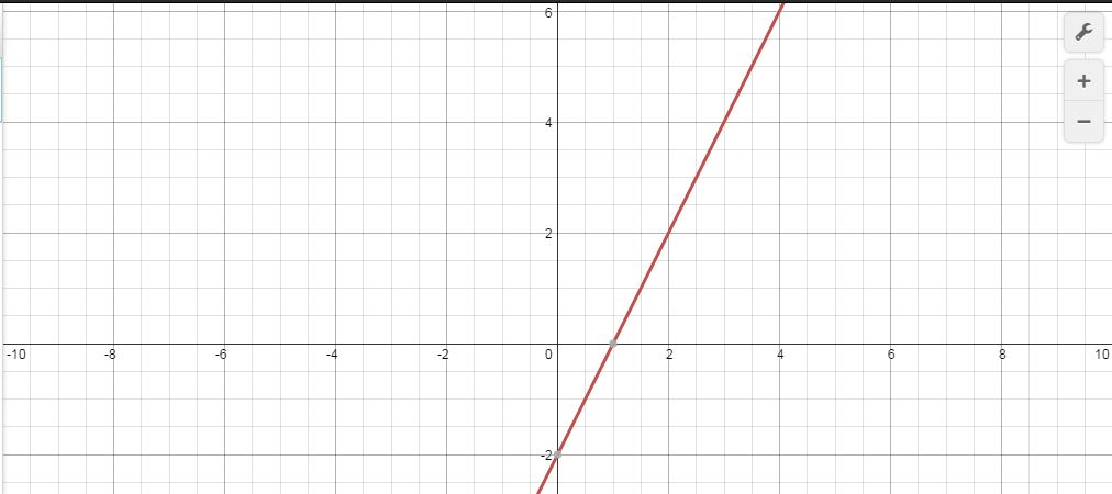

For $y=0 \Rightarrow x=1$ and for $y=2 \Rightarrow x=\frac{1}{2}$.But I found that this is the graph of $2x-y=2$ :View attachment 5093
So are the points that I have found above wrong? Or where is my mistake? (Thinking)

Hey evinda! (Smile)
In your drawing you have the line $2x+y=2$ instead of the line $2x-y=2$. :eek:

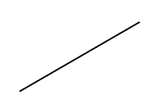

I like Serena said:
Hey evinda! (Smile)

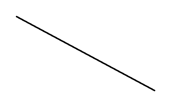

If we take pick $y=0$ we get $x=1$ and if we pick $y=2$ we get $x=2$.
Then we would get a line like this:
But picking $y=-2 \Rightarrow x=0$ and $y=1 \Rightarrow x=\frac{3}{2}$ we get a line as below:
Or am I wrong? (Thinking)

Your first line is for $2x+y=2$ while the second is for $2x-y=2$.
It should be like the second.
Note that if we substitute $y=2$ in $2x-y=2$, we get $-2=2$.

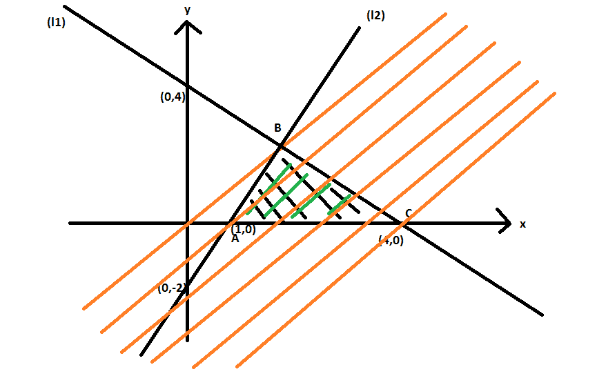

Yes, I noticed it too now... I am sorry... Thank you! (Smile)
I will try to find now the optimal solution...
We also draw at the same graph the line $x-y=0$.
We consider the line $x-y=\lambda, \lambda>0$ where $\lambda$ is increasing.
Do we deduce from the graph that the optimal solution is $C(4,0)$ since it is the last line? (Thinking)
Yep. (Nod)
