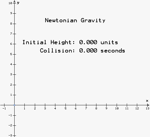

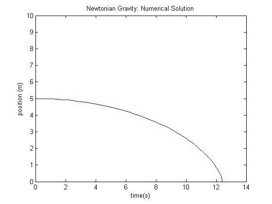

Here's the final solution I found, in parametric form:
$$\begin{cases}
x = \sqrt{\frac{x_i}{2}}\Bigg(\sqrt{Tx_i-T^2} - x_i\sin^{-1}{\Big(\sqrt{\frac{T}{x_i}}\Big)} + \frac{x_i\pi}{2}\Bigg)\\
y = T
\end{cases}$$
where x is x and y is t. When graphing, it is best to do it from ##T = 0 \to x_i##
I could really not have imagined a better result... I have spent months convinced that an analytical solution to this DE was impossible. In celebration, here's how it should look when graphed:
