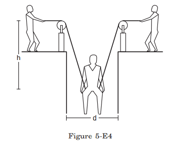

A man has fallen into a ditch of width d and two of his friends are slowly pulling him out using a light rope and two fixed pulleys. Show that the force (assumed equal for both the friends) exerted by each friend on the rope increases as the man moves up. Find the force when the man is at a depth h.

The correct solution uses angles and trigonometry. My solution is as following:
- Suppose the forces exerted by friends 1 and 2 are F1 and F2 respectively.
- There are no net force in the x-direction, so F(total x) = 0.
- F(total y) = F1 + F2 - mg = 0 (initially). Rearranging gives g = [F1+F2]/m
- Initial velocity = 0, I've chosen the origin of my co-ordinate system to be at the initial y-position of the person being pulled up so initial position is (0,0). So H = 1/2gt2
- Insert g gives H = [F1+F2]t2]/2m
- From this equation I gathered that H is proportional to F1 and F2. So as the height increases, F1 and F2 should increase as well (since they're equal). I made an assumption here that the rescue must happen within a limited time frame so greater height must be achieved with greater forces.
- Since the taut ropes make a right-angled triangle with the lip of the ditch, I take the base of the triangle on one side to be d/2, the height h, and the hypothenuse F1. F1= sqrt(h2+(d/2)2).
- So the F(total y) at height h = 2sqrt(h2+(d/2)2)-mg
Is this a valid alternative solution to this problem?

Hello @Angetaire ,
:welcome: ##\qquad ## !​
In the line just above, you have written that ##F_1 + F_2 = 0 ## (equal and opposite) !
Anyway: make a sketch for the case the ropes are at 45 degrees -- you see that F1 and F2 each have a y-component that is not equal to the magnitude ...
Angetaire said:
H = 1/2gt2
There is no free fall in this exercise ! Neither downward (unless one of the 'friends' let's go :smile: or the rope breaks), not upwards !
