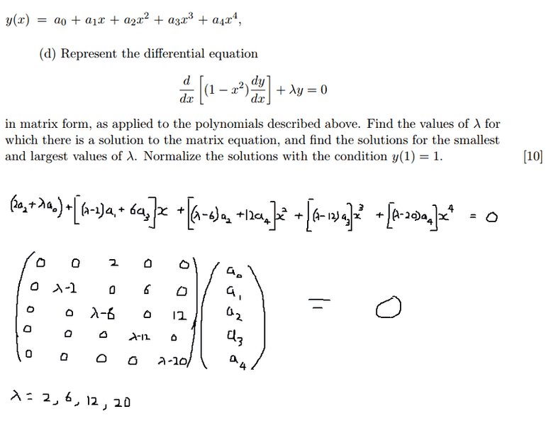

Let y(x) = a0 + a1x + a2x2 + a3x3 + a4x4
Represent the differential equation
(d/dx)[ (1-x2)(dy/dx) ] + λy = 0
in matrix form. Find the values of λ for which there is a solution to the matrix equation, and find the solutions for the smallest and largest values of λ. Normalize these solutions with the condition y(1) = 1.
I got as far as finding the values of λ = 0, 2, 6, 12, 20. Am i supposed to plug in the values of λ into the differential equation and solve it by finding the characteristic equation by assuming y = Aeβx? But the question gives y as a polynomial: y(x) = a0 + a1x + a2x2 + a3x3 + a4x4

Check your matrix. You are missing a λ in the first row. That will give you another value for λ. And you are supposed to substitute the values of λ into your matrix and find corresponding a's.
Oops i wrote my matrix wrongly from my working on paper. The smallest value of λ = 0.
I don't understand what you mean by "finding the corresponding a's".
Say i sub in λ = 0. All i get is: BA = 0, where B is the matrix with the subbed value of λ and A is the column with all the a0, a1, ...
For example, let's consider [5,5].
(-20)(a4) = 0.
This doesn't mean anything other than a4 = 0. Then it would mean a0 = a1 = a2 = a3 = a4 = 0

You are jumping to conclusions. Just because a4=0 doesn't mean ALL of they a's have to be zero. They don't. Which one doesn't?
Taking λ = 0,
Let's start with the bottom row.
-20a4 = 0,
=> a4 = 0
-12a3 = 0
=> a3 = 0
-6a2 + 12a4 = 0
=> a2 = 0
-2a1 + 6a3 = 0
=> a1 = 0
and finally 2a2 = 0

You forgot a0.
Dick said:
You forgot a0.
I put in λ = 0 into the matrix at [1,1]. This gives a0 = 0 as well..
No, it doesn't.
vela said:
No, it doesn't.
0 * a0 + 2a1 = 0
does this mean a0 can be any real number?
To satisfy that equation, yes. But it needs to be non-zero because you're looking for a non-trivial solution to the system of equations.

Then when i sub in λ = 20,
I have a4 = any real number,
a3 = 0,
a2 = -(6/7)a4
a1 = 0
a0 = 0
is this right?
You shouldn't get ##a_0=0##. The rest are right.

For λ = 0
-20a4 = 0,
=> a4 = 0
-12a3 = 0
=> a3 = 0
-6a2 + 12a4 = 0
=> a2 = 0
-2a1 + 6a3 = 0
a1*0 = 0
a1 [itex]\subset[/itex] ℝ
is it because from the condition:
y(1) = 1
a0 + a1 + a2 + a3 + a4 = 1
So, a0 = 1
For λ = 20
=> a4 [itex]\subset[/itex] ℝ,
=> a3 = 0
14a2 + 12a4 = 0
=> a2 = (-6/7) a4
18a1 + 6a3 = 0
=> a1 = 0
20a0 + 2a2 = 0
=> a0 = (-1/10)a2 = (3/35)a4
Using a0 + a1 + a2 + a3 + a4 = 1
a0 = 3/8
a1 = 0
a2 = -48/245
a3 = 0
a4 = 35/8

All correct, except your final a's for λ=20 don't sum to 1.
