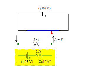

The emf of a battery A is balanced by a length of 75 cm on a potentiometer wire. The emf of a standard cell, 1.02V, is balanced by a length of 50 cm. What is the emf of A?
Calculate the new balance length if A has an internal resistance of 2 Ω and a resistor of 8 Ω is joined to its terminals.

That depends upon your interpretation of the circuit description. Do you consider the 8 Ω resistor to be in series with the A cell (and its internal resistance of 2 Ω), or in parallel with it? The description does say "terminals" (plural)...
What's the current drawn through the potentiometer connection when the system is balanced? Perhaps sketching your interpretation of the circuit diagram and labeling all known values would be helpful.

Okay, so the problem is with your interpretation of the circuit description. The 8 Ω resistor is connected to BOTH terminals of the A cell, not just one. That is, it is in parallel with the cell. See here (I use MS Visio for drawings, by the way):
From your knowledge of how a potentiometer circuit works, what is the current ##I_s## when the circuit is balanced?

It's zero. But other than that, I still don't know how to proceed. Is the voltage drop across the potentiometer equal to the voltage across 8 Ω resistor and cell A?

If that current is zero then the cell + resistor is essentially an isolated circuit (no current enters or leaves this circuit "island". You can determine the local current and all potential drops in this subcircuit.
Yup.
And how did you get 2.04 V?
From the standard cell test conditions described in the problem statement. 50 cm is half the 100 cm of the full potentiometer wire.

We're doing this because there will be current in this loop , which will , however , not move out of this loop ( as galvanometer shows zero reading ) .
We then just write Kirchoff ' s loop law , for this particular loop .

It might be beneficial to have a labeled circuit diagram to refer to in order to avoid ambiguities during discussions. Here's an attempt that I hope will help:
