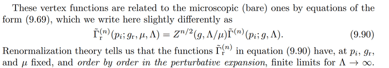

I'm learning about the RG equation and Callan-Symanzik equation. In ref.1 they claim to solve the RG equation via the method of characteristics for PDE. Here's a picture of the relevant part:

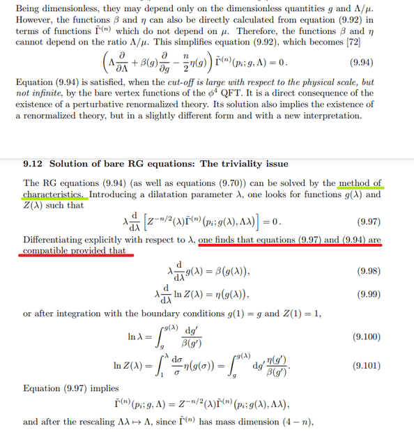

First, the part I don't understand - the one underlined in red. What does "compatible" mean here? Upon explicit differentiation one gets
$$Z_{\text{eff}}^{-n/2}(\lambda)\left[\Lambda\frac{\partial}{\partial\Lambda}+\lambda\frac{d}{d\lambda}g_\text{eff}(\lambda)\frac{\partial}{\partial g_\text{eff}}-n\cdot\frac{1}{2}\lambda\frac{d}{d\lambda}Z_\text{eff}(\lambda)\right]\Gamma_0(p_i;g_\text{eff}(\lambda),\lambda\Lambda)=0\tag{9.97a}.$$
Even if "compatible" just meant that they don't contradict each other, I don't see why ##(9.98-9.99)## specifically should hold. If anything, the choice doesn't seem unique, does it?
Secondly, I'm unsure about the method of characteristics here: it looks very different from the standard method I know (see this question on Physics.SE). I have never seen this dilatation parameter anywhere else, except other books having ref.1 as a reference, is there any source you can advise?
By the way, the independent variables should be ##g## and ##\Lambda## in eq. ##(9.94)##, so I guess that once one writes it down, we disregard that ##g=g(\Lambda)## - used to derive the equation and regard it as an independent variable, right?

  1. I find the "compatibility" argument quite mystifying, so it would help to have someone flesh this step out.
  2. Not only that, but also their ad hoc introduction of ##Z(\lambda)## as "running" field strength renormalization, which is not the same $Z$ appearing in the equation relating the bare and the renormalized field, which with e.g. a cutoff regularization depends on the cutoff scale (below the definition of the same reference):

To avoid confusion with the notation, I'll switch the notation from ##\lambda\to u## for the parameter. Furthermore, I'll use the ##_R## subscript for renormalized quantities and ##_0## bare quantities.
I'll start from the very beginning, i.e. how the RGE is derived in my case. After a ##\Lambda## cutoff regularization and field-renormalization, the bare ##n-##point function is related to the renormalized (with momenta ##p_i##) as follows
$$\Gamma_R(p_i; g_R, \mu)=Z^{-n/2}\left(g_0(\Lambda), \frac{\Lambda}{\mu}\right)\Gamma_0(p_i; g_0(\Lambda), \Lambda)\tag{1}\label{1}$$
where ##\mu## is a renormalization scale, such as ##\mu=m_R## and the bare coupling has cutoff dependence.
Then, using the fact that $\Gamma_R$ is independent of $\Lambda$,
$$\Lambda\frac{d\Gamma_R}{d\Lambda}=0\overset{(1)}{\implies}\left[\Lambda\frac{d}{d\Lambda}+\Lambda\frac{dg_0}{d\Lambda}\frac{\partial}{\partial g_0}-\frac{n}{2}\Lambda \frac{d}{d\Lambda}\log Z\right]\Gamma_0(p_i; g_0(\Lambda), \Lambda)=0\tag{2}\label{2}$$
Now let $$\beta(g_0)=\Lambda\frac{dg_0}{d\Lambda} \qquad \eta(g_0)=\frac{1}{2}\Lambda \frac{d}{d\Lambda}\log Z\tag {2a}\label{2a}$$
so the remaining RGE is
$$\left[\Lambda\frac{\partial}{\partial\Lambda}+\beta(g_0)\frac{\partial}{\partial g_0}-n\eta(g_0)\right]\Gamma_0(p_i; g_0, \Lambda)=0.\tag{3}\label{3}$$
Now that we have derived the equation, we may regard ##g_0## as an independent variable and study the solution of the PDE. Either using \eqref{3} (where ##g_0## and thus ##\beta## and ##\eta## are independent of $\Lambda$) or \eqref{2} , it's evident that upon rescaling ## \Lambda\to u\Lambda## in the argument of ##\Gamma_0##, equation{3} is unchanged and we find that for ##u\in\mathbb{R}##
$$\left[\Lambda\frac{\partial}{\partial\Lambda}+\beta(g_0)\frac{\partial}{\partial g_0}-n\eta(g_0)\right]\Gamma_0(p_i; g_0, u\Lambda)=0.\tag{3a}\label{3a}$$
Ok, now I have what I need. To find a solution of \eqref{3}, we define two functions ##g(u)## and ##Z(u)## such that (for the sake of clarity, I'm still calling the derivative of ##\Gamma_0## wrt the first and the second argument respectively as ##\partial\Gamma_0/\partial \Lambda## and ##\partial\Gamma_0/\partial g_0##)
$$u\frac{d}{du}\left[Z^{-n/2}(u)\Gamma_0(p_i;g(u), u\Lambda)\right]:=0\iff Z^{-n/2}(u)\left[\Lambda\frac{\partial}{\partial\Lambda}+u\frac{d}{du}g(u)\frac{\partial}{\partial g_0}-n\cdot\frac{1}{2}u\frac{d}{du}Z(u)\right]\Gamma_0(p_i;g(u),u\Lambda):=0\tag{4}\label{4}.$$
where the ##:=## symbol is a reminder that ##g(u)## and ##Z(u)## are to be determined such that the equality is satisfied. Comparing \eqref{4} to \eqref{3} we immediately see that if
$$\begin{cases}u\frac{d}{du}g(u)=\beta(g(u)) \\
\frac{1}{2}u\frac{d}{du}\log Z(u)=\eta(g(u)) \end{cases}\tag{5}\label{5}$$
then \eqref{4} is reduced to \eqref{3a} (which is true being out starting point), with ##g_0\to g(u)##, so \eqref{5} is indeed a definition (not unique I guess) that grants \eqref{4} to be true as we wanted.
Finally, observe that our condition \eqref{4} amounts to ##u##-independence, i.e.
$$Z^{-n/2}(u)\Gamma_0(p_i;g(u), u\Lambda)=Z^{-n/2}(1)\Gamma_0(p_i;g(1), \Lambda)\overset{(\star)}{=}\Gamma_0(p_i;g_0, \Lambda)\tag{6}\label{6}$$
from which we see that sensible initial conditions for \eqref{5} are given by ##g(1)=g_0## and ##^{(\star)}Z(1)=1##.
At this point we may stop treating ##g_0## as an independent variable and restore its cutoff dependence in \eqref{6}.
