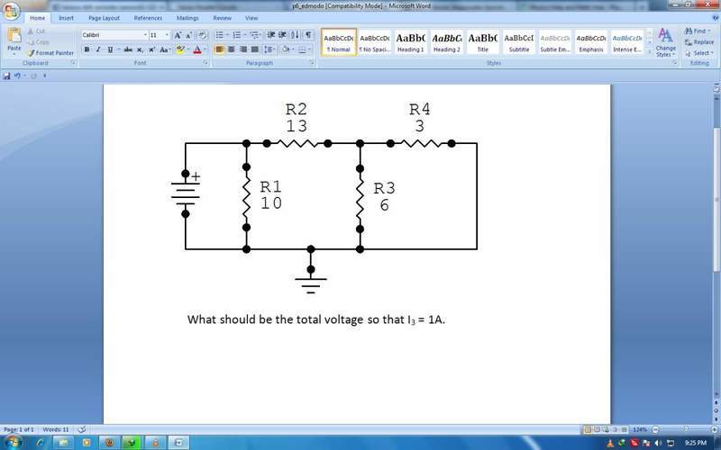

R1-10
R2-13
r3-3
R4-6
What should be the total voltage so that I3 = 1A.
n/a
idk to solve it help me plss :(

1. You haven't identified where I3 is (Is it the current through R3?).
2. There must be relevant equations! Otherwise, how would such problems get solved?
3. You need to provide some attempt at a solution, or at least some discussion of what you've already tried.
ohh sorry so this is my attempt.
1. You haven't identified where I3 is (Is it the current through R3?).Yes
http://en.wikipedia.org/wiki/Ohm's_law
Rt=R1+R2+R34
Rt=10+13+2
Rt=25
I3=1
V3=I3R3
V3=1(6)
V3=6
I4=I2-I3
I4=I2-1
I2-I4=1
Have you not learned about Kirchhoff's laws? KVL? KCL?
Rt=R1+R2+R34
Rt=10+13+2
Rt=25
Note that R1 is in parallel with the voltage source (let's call it V) . If the voltage source is ideal then the potential with respect to ground at the node where R1 and R2 meet is fixed by V regardless of the value of R1. So we can expect that the value of R1 will not play a role in determining V.
It's not clear why you calculated Rt above, or what it represents, since R1 is not in series with R2 and R3||R4.
I3=1
V3=I3R3
V3=1(6)
V3=6 <--- Okay, good!
I4=I2-I3
I4=I2-1
I2-I4=1 <--- Okay! (Note that you've used KCL) :wink:
Since you've determined the voltage that appears across R3 above, what can you say about the current through R4?
