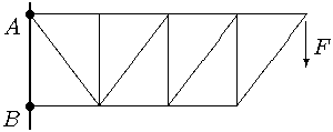

The truss is suspended by two pin joints at A and B. Each of the four segments is 3 m wide and 4 m high. Find the reaction force at A
d
sum of forces y = -ay + by -f=0
Can someone tell me what the moment at B is?
Mb = -4*w*F + 0*Ay - Ax*h = 0
i don't know if that is right. Ay and ax confuse me
Hmm I got that Ax = -3F but I can't figure out what Ay is
Any thoughts?
Hmm, a friend told me Ay = F but.. I don't understand why?
Once you know Ax, and, then, Bx, consider the moments of the forces about the point where F is applied. That will give you an equation linking Ay, Bx, and By.
Thank you
but I don't know what Ay and By are, so that wouldn't help me would it?
You have an equation that relates them.
You have posted another equation with them in #1.
Two equations, two unknowns, problem solved.

Are you sure that both joints are pinned hinges and that there is not a roller support at B that would make it incapable of supporting vertical load? If the support at B was a roller support , then Ay = F. But if both A and B supports can support vertical loads, then the problem is statically indeterminate because you have 4 unknowns Ax Bx Ay and By, and only 3 equilibrium equations. It only affects the forces in AB, in either case. You may assume Ay = By = F/2, if both supports are full hinges capable of taking loads in the x and y directions.
Yes indeed. Using my "method", I end up having two identical equations, as was to be expected if I had thought straight. Not sure what I was thinking.
"Ay = By = F/2"
but Ay is -3F and By = 3F (which is the correct answer)
Also there are no rollers in this problem only pins.
NoobeAtPhysics said:
"Ay = By = F/2"
That is not the correct answer for Ay and By. That is the correct answer for Ax and Bx (you correctly solved for Ax in your 2nd post). Note: It is assumed that x is the horizontal axis and y is the vertical axis.
