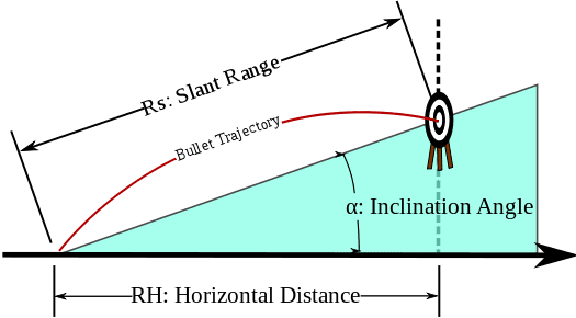

In a process of writing a game. Effectively need to know how to angle the barrel for the projectile to hit the selected target.
So for the equation
y = h + x * tan(α) - g * x² / 2 * V₀² * cos²(α)
Everything except α is known. Could anyone more wise in the ways of science than me help me solve for alpha?
Thanks

You know the starting height ##h## and the velocity ##v_0## and you want to find the launch angle required to hit a fixed target ##(X, Y)##?
@PeroK that is correct, yes. I suppose it's safe to say that Y will always be zero (not sure if that's of any help)
You should be able to get a quadratic equation for the tangent of the launch angle. It may be a bit messy, but you just put these two equations together, by getting rid of ##t##:
BvU said:
$$\begin{align*} x&=\ \phantom{h +}v_0\cos\alpha\ t \\
y&=h + v_0\sin \alpha\ t - {1\over 2} g\,t^2 \end{align*}$$
Getting rid of ##t## results in OP's original equation. For ##\alpha## that's like $$y_T - h = x_T\tan\alpha - {1\over 2} g\left ( x_T\over v_0\right)^2{1\over\cos^2\alpha} $$
That's a quadratic in ##\tan \alpha## if you use ##\sec^2 \alpha = 1 + \tan^2 \alpha##.
@PeroK I'm not quite as nimble as you are I'm sure as far as math goes, what would the quadratic look like in the end? And ultimately, how would that be solved for α?
P.S. I really appreciate you guys helping me on this, I thought this thread was going to go unnoticed and ultimately die
You can simplify things a bit, by setting ##\mu = \frac{v_0^2}{gx_T}##, which is dimensionless. And, noting that ##\frac{y_T - h}{x_T} = \tan \theta## is the tangent of the angle from the launch point to the target. This gives: $$\tan \theta = \tan \alpha - \frac{1}{2\mu}(1 + \tan^2 \alpha)$$ Re-arranging gives:
$$\tan^2 \alpha - 2\mu \tan \alpha + 1 + 2\mu \tan \theta = 0$$ And if you hit that with the quadratic formula you get: $$\tan \alpha = \mu \pm \sqrt{\mu^2 - 2\mu\tan \theta - 1}$$

@BvU @PeroK @Mark44
Wow thanks guys, this is awesome! Works flawlessly.
Plus this resource is really nice to have out there, since hours and hours of googling didn't yield a solution for this, even though it seems like a very useful function.
Thanks again!
