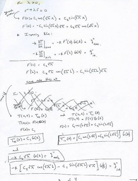

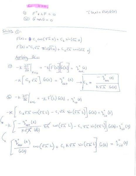

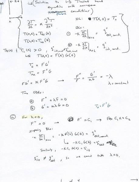

Hi, it is easy solving these PDEs with the idealized homogeneous BCs they throw out in class, but I am having some difficulty solving the transient problem posed in the images below. I have tried working through it, but I don't have confidence in the result. I overlook the solution when the eigenvalues are 0 because that results in the derivative boundary conditions having to equal each other at all times, which is not true for the problem at hand. I also took the cosh and sinh route when the the eigenvalues are negative, but that was giving me similar C1 and C2 formulations as when the eigenvalues are positive. May I please get some direction as to where I'm going wrong? Does the end result make sense? I don't mind not solving for eigenvalues now as the intention is to have a symbolic representation.

I'm confused about the boundary conditions. Are you specifying the temperatures at the two boundaries as functions of time, or the heat fluxes at the two boundaries?

The actual boundary conditions of interest specify the heat fluxes; however, the heat fluxes are dependent on the temperatures on the boundaries, which are also unknown.
I just also include T(0,t) and T(L,t) being non-zero and positive. Is it wrong of me to impose those Dirichlet conditions in the solution process?

EDIT: I have tried to resolve it using only the derivative conditions: What irks me is that G(t) disappears, which means the thermal diffusivity disappears. That doesn't give me confidence in the solution.

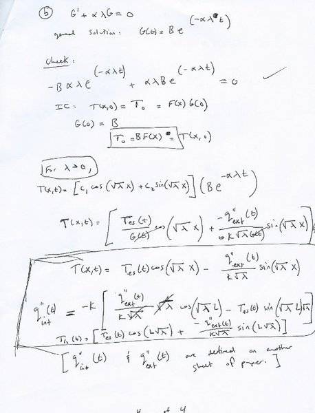

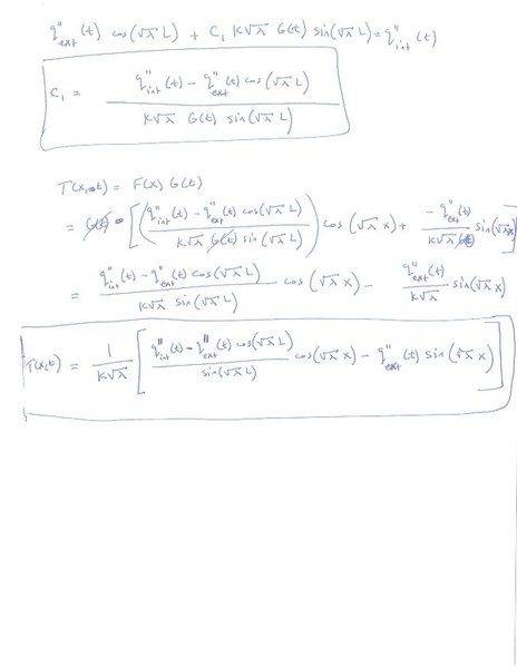

Solving for the general solution of the linear governing equation should be straight forward. The BCs just complicate getting expressions for the coefficients. Do you think what I have done in post #3 is wrong?

I haven't looked over your detailed analysis, but the final result in post #3 does not look correct. The temperature profile at time t should involve integrals over the history of the flux variations at the boundary, not just the present values of the fluxes. The boundary conditions are going to be bears to deal with if you are going to try to solve the problem by your present method.
As an experienced heat transfer guy, I can tell you that this is not the way I would ever approach this problem. I would start out by "doping things out," which means getting an idea of the kinds of approximations I can make to simplify the solution (possibly getting an analytic solution), while at the same time not sacrificing accuracy. This would depend on the specific parameters for the system. My next best choice would be to solve the problem numerically, which should be a snap.
