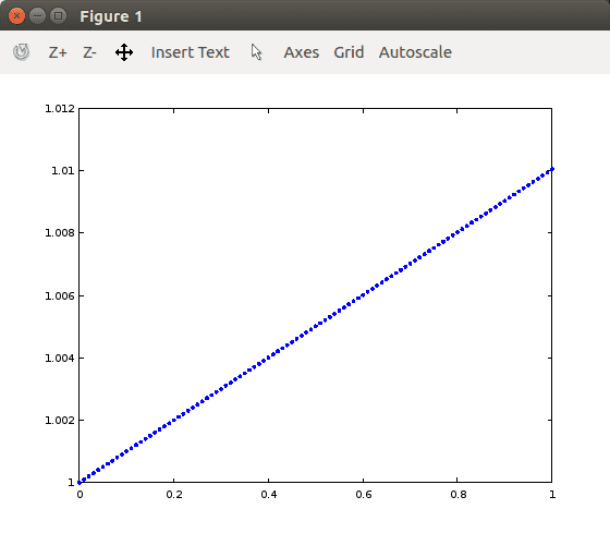

evinda said:
Great. (Blush) I also want to represent in common graphs the corresponding values of $(x^n)^2+(y^n)^2$.
So do we add at each of the above for-loops the command [M] plot(y(1)^2+y(2)^2)[/M] after the calculation of y? (Thinking)
Well, according to description of plot, we have:
plot(Y) creates a 2-D line plot of the data in Y versus the index of each value.
That means that the first time we get a plot of the first point at x-coordinate 1.
The second time that plot is replaced by a plot of a single point that is again at x-coordinate 1.
And so on, ending in the plot of a single point that corresponds to the last iteration.
That's not what we want, is it? (Worried)
To add to the plot instead of replacing it, we can call [M]hold on[/M].
And perhaps we should specify an x-coordinate of, say, [M]i*h[/M]? (Wondering)
I haven't really understood how we use the command plot. Could you maybe explain it further to me? (Worried)
Suppose we do:
Code:
N=100;
h=1/N;
y=[1;0];
A=[0 -1;1 0];
plot(0, y(1)^2+y(2)^2);
hold on;
for (i=1:N)
      y=(eye(2)+A*h)*y;
      plot(i*h, y(1)^2+y(2)^2);
end
hold off;
y
We use the plot(X,Y) command, which is described as:
plot(X,Y) creates a 2-D line plot of the data in Y versus the corresponding values in X.
Then the first plot command will create the plot and put one value in there at x-coordinate 0.
Calling [M]hold on[/M] means that we want to hold the plot, such that subsequent plot commands get added to the same plot until we call [M]hold off[/M]. Without it, the previous plot command would be discarded.
And [M]plot(i*h, y(1)^2+y(2)^2)[/M] plots the desired value at the corresponding x-coordinate, which is [M]x=i*h[/M].
The result is:
(Thinking)

I like Serena said:
Suppose we do:
Code:
N=100;
h=1/N;
y=[1;0];
A=[0 -1;1 0];
hold on;
for (i=1:N)
      y=(eye(2)+A*h)*y;
end
hold off;
y
The result is:
(Thinking)
Ah I see... Like that we get the plot of the approximation of $x^2+y^2$ at each time $t_i=0+ih$, right?

[M]tt=[tt, i*h][/M] creates a new row vector by adding [M]i*h[/M] to the right of [M]tt[/M].
[M]yy=[yy, y][/M] creates a new matrix by appending the column vector [M]y[/M] to the right of the matrix [M]yy[/M].
Afterwards [M]yy[/M] contains all the iterations of [M]y[/M], and [M]tt[/M] contains the corresponding t-values. (Thinking)
Nice... Thank you very much! (Happy)
