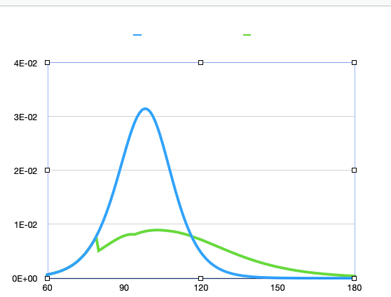

Model Results With- and Without Amelioration (Solution to Eqns. 1 in post #7)
FRACTION INFECTED PER DAY AS A FUNCTION OF NUMBER OF DAYS
Blue line - Without amelioration
Green line - With amelioration (hibernation and social distancing measures)
Initial conditions:
Fraction susceptible initially 0.999999
Fraction infected and contagious initially 0.000001
Fraction recovered initially 0.
Scenarios:
Without amelioration: k* = 0.17/day (representing a doubling time of about 5 days)
With amelioration: k* changed to 0.1/day at day 80 (corresponding to current estimates of Ro)
Time interval each person is contagious: 14 days
These results seem to be consistent with what they have been telling us on TV. An interesting feature is that the peak with amelioration comes only about 5 days after the peak without. I would have expected it to come much later. The ultimate fraction that is infected is almost 90 percent without amelioration, and only 55 percent with amelioration.
The results also suggest (not shown here) that we ought to wait about a month after the peak before starting to ease up on restrictions; otherwise there can be significant flare-up.
It's amazing that such a simple model can yield so much useful information.

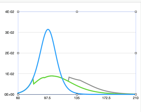

I'm going to also look and an easing scenario where I go back half-way at day 125.
EFFECT OF EASING RESTRICTIONS (HALF-WAY), 45 DAYS AFTER STRONG RESTRICTIONS WERE IMPOSED AT DAY 80
Probably it would be much better to wait another 15 days.
