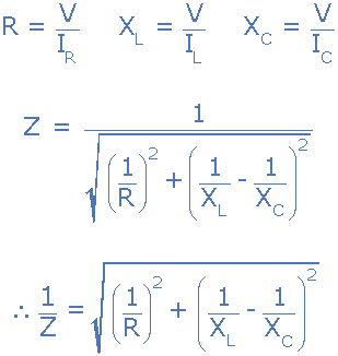

what is the value combined impedance of the parallel circuit ?when R=25 ,X[c]=100 and X[L]=25
I think we use this equation to solve parallel impedance ...
z=1/√((squ(1/25))+(squ((1/25)-(1/100))))=1/√(1/625)+squ(3/100)=√10000/25=100/5=20
but the ans is given is 120 what I do ?

with your value(R=25,XL=25,XC=100) and your equation you found the right answer. Maybe you forget to convert L and C value to phasor form, it means ( XL=JwL not XL= L) or the book answer is wrong

Perhaps it is a typo. The answer is j20, not 120.
The equivalent impedance of a bunch of parallel impedances is less than the least of them, which means the answer is less than 25.
