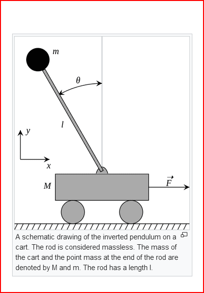

When the rocket engine is at the bottom, it's an inverted pendulum type of control system, right?

https://en.wikipedia.org/wiki/Inverted_pendulum
Yes/agreed.
