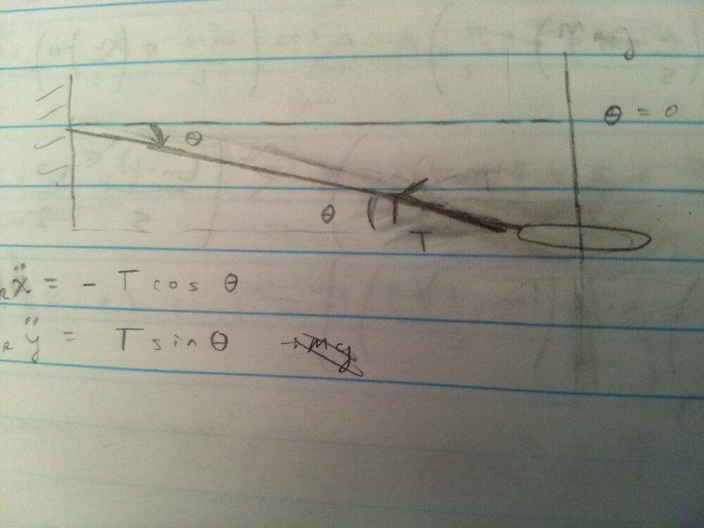

In that case, I have two equations of motion for the massive ring. $$M_R \ddot x = -T\cos(\theta)$$ and $$M_R \ddot y =T\sin(\theta)$$ And ##\theta## would be the angle measured down from the horizontal, like in the drawing below.
The ring doesn't move horizontally. So, ##\ddot x = 0##. There is another horizontal force acting on the ring besides ##T \cos \theta##.

TSny said:
The ring doesn't move horizontally. So, x¨=0. There is another horizontal force acting on the ring besides Tcos⁡θ.
Whoops. The contact force from the rod.
TSny said:
Also, check your signs in the equation for y¨.
I've now made ##\theta## going up from the horizontal and specified y accordingly. So I have ##M_R\ddot y = -T\sin\theta##
So then following both your advice on the approximation ##M_R\ddot y \approx \frac {-Ty} {l}## where ## \tan\theta = \frac {y} {l}##.
