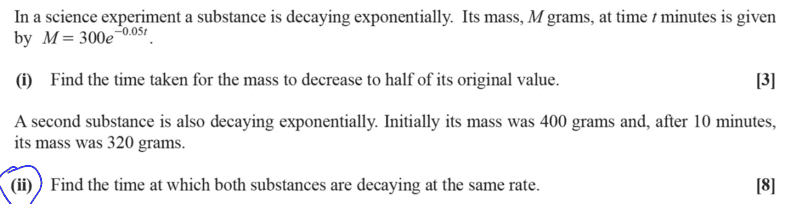

Kindly see attached.
exponential function and its derivatives
My interest is on question ##11.ii## only. I think there is a mistake on the markscheme...i just need a second opinion on this...find attached the question and markscheme...

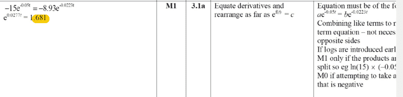

markscheme here:
it ought to be,
##e^{0.0277t}=1.6797##
Given the precision in the previous step, quoting anything more precise 1.7 is probably pushing it.
Likes PhDeezNutz and chwala
I think mark scheme is just fine...you are also correct...i would probably say ##1.68## to 3 significant figures...
