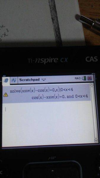

solve xsin(x)-cos(x)=0 on interval (0,4) using the calculator
xsin(x)-cos(x)=0
I have tried working the problem out through first pressing menu- 3 (algebra)- 1 (solve)- inserting the equation- inserting the interval.
However, when I press the enter button, I get this equation instead of solid solution(s).
Below is my work on the graphing calculator.

You're missing a couple of steps. Here's a quick tutorial on how to do that exact kind of problem analytically (as opposed to graphically) on the N-Spire.

I tried the exact steps, and the solution turns out the same way.
I don't know why, but it works on ti 84

yes but i want to know how to do it without graphing it!
It looks like you have ##\ xsin(x)\ ## rather than ##\ x\cdot\sin(x) \ ##.
So it's not treating ##\ sin\ ## as a function.
Likes ComplexVar89 and Sunwoo Bae
thanks it worked!
