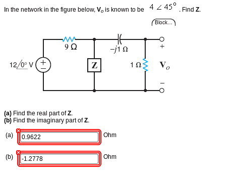

So my plan is as follows:
Find the current through the 1 ohm resistor, multiplying this by the combined impedance of the capacitor & 1 ohm resistor. Now I know the voltage across the unkown impedance Z. Subtract this voltage from the 12 V source, now I know the voltage through the 9 ohm resistor. Use KCL to find the current through Z, and use V=IZ to find the unknown impedance.
Current through 1 ohm resistor: 4(45d)
Voltage through 1 ohm resistor & capacitor: 4(45d)(1-j1)=5.66(0d)
Voltage through 9 ohm resistor: 12(0d)-5.66(0d) = 6.34(0d)
Current through 9 ohm resistor: 6.34(0d)/9 = 0.7044(0d)
By KCL:
-Ic + Iz + Io = 0
Iz = Ic - Io = 0.7044(0d) - 4(45d) = 3.54(53d)
V/Iz = 5.66(0d)/3.54(53d) = 1.6(-53d) = 0.963-1.278j
But this is wrong, and I've been trying to figure this out for a good hour now, but keep getting the same answer. So I conclude that there's something wrong with my approach.
I think you want to check your KCL. There is one current flowing into the node and two flowing out. Which is which?
Likes x86
Yes. My sign convention is (-) for in, (+) for out. Iz is the current across Z, Io is the current through the resistor/capacitor, Ic is the current through the 9 ohm resistor.
The angle of your Iz looks suspicious. What was your rectangular version?
Likes x86
0.7044 - 2sqrt(2) - 2sqrt(2)j
-2.124-2.823j
3.537(53d)
-2.124-2.823j
3.537(53d)
Yeah, both terms are negative. In what quadrant should the resulting angle lie?
Likes x86
The quadrant where x<0 and y<0, so this means that the answer is 3.537(-53d)
Even so, this doesn't change the real answer, it is still 0.963
But the complex part is correct. Perhaps I'll redo this problem tomorrow when I'm more awake. I really need to focus on the little things more!
Thanks
-53° is in the 4th quadrant where x > 0...
Yes you are right. Sorry about that, I was up very late last night and havent' slept well lately.
