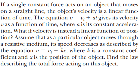

For this problem,
My working is
## \vec F = m\vec a##
## \vec F = \frac {m(v - v_i)}{\Delta t} ##
## \vec F = \frac {-mkx}{\Delta t} ##
However, the solution said ##\vec F = -mkv ##. I don't understand how this is possible since ## v ≠\frac {x}{\Delta t} ## since ##v =\frac {\Delta x}{\Delta t} ##?
Many thanks!

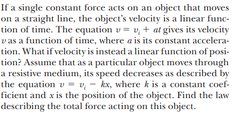

For this problem,
My working is
Many thanks!
You do not take a finite difference, you take the derivative of v with respect to t to get acceleration.

I was trying to solve this problem using the algebra definition of velocity only. It's possible to solve this problem without calculus right?

Yes, but you took the finite difference wrong. You want start with Δv/Δt.
Hint: Δvi=0 since it is a constant.

I though ##\Delta v = v_f - v_i = v - v_i ## since they drop the ##f## for ##v##

vi is just a constant. It could have just as easily been labeled a. vf is not in the original problem.
Δv=Δvi-Δ(kx)
Since k is also a constant you can pull it outside the Δ.
Likes member 731016
I wouldn't try it without calculus. Calculus is your friend here.
Might this be of help?$$a=\frac{dv}{dt}=\frac{dv}{dx}\frac{dx}{dt}=v\frac{dv}{dx}.$$

The "algebra definition" ##\frac{\Delta x}{\Delta t}## is for the average velocity over the time interval ##\Delta t##. You need to use the definitions of instantaneous velocity and instantaneous acceleration, which can only be expressed in calculus.

I have figured out how solve to the problem using algebra. The calculus way as a lot faster thought!
## v_i = v(x_i) = v_i - kx_i ##
## v_f = v(x_f) = v_i - kx_f ##
## \Delta v = v_f - v_i= v_i - kx_f - (v_i - kx_i) = -kx_f + kx_i = k(x_i - x_f) = -k\Delta x ##
Then plug ##\Delta v## into Newton II to get their answer :)

I assume your final steps are
##\frac{ \Delta v }{\Delta t}= -k\frac{ \Delta x }{\Delta t}##
##a=-kv##
But as I pointed out, that doesn’t quite work because the final line above should read
##a_{avg}=-kv_{avg}##, where the averages are taken over the time interval.
To get the target answer you need to apply the calculus principle of letting the deltas tend to zero.

Thank you for your reply @haruspex!
Your assumption of my finial steps is correct
I agree that I should has used average notation including ##F_{avg}##
However, would you please know why are looking for the instantaneous force not average force from the question?
Many thanks!
My answer would be because Newton's law is not ##F_{avg}=ma_{avg}##. Perhaps @haruspex has some other answer.

Because the question does not specify average it should be taken as meaning instantaneous.
