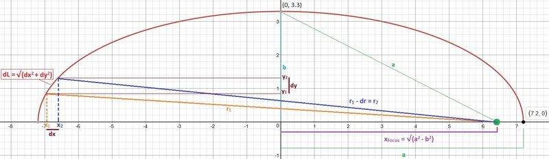

I have made an illustration to clarify my idea how one could calculate the circumference of an ellips.
The x and y coordinates of every distance ##r## and ##(r - dr)## from the focus to any point on the circumference of the ellips can be calculated using the formula for the ellips ##y = \sqrt{b^2(1-\frac{x^2}{a^2})}## and Pythagoras theorem. The difference in x- and y coordinates ##dx## and ##dy## can then be used to calculate a piece of the circumference ##dL## through Pythagoras theorem again. I am exaggerating the magnitude of ##dL## in the picture above.
Dividing each calculated ##dL## by the formula for the speed ##v = \sqrt{GM(\frac{2}{r} - \frac{1}{a})}## in which ##r## is the midpoint between ##r## and ##r - dr## would give the small time interval over ##dL##. Doing this for each piece of the circumference of the ellips and adding all those time intervals together would give the time duration for mass ##m## to travel half the ellips as shown in the picture. So multiplying this by 2 would give the period of ##m##. This is again if ##M## is so large that it is basically in the focus point of the ellips (green dot in the picture).
I was wondering if this is a correct technique to calculate the correct time period for a mass ##m##. My technique sounds like a summation instead of an integration but I'm not sure regarding this.
