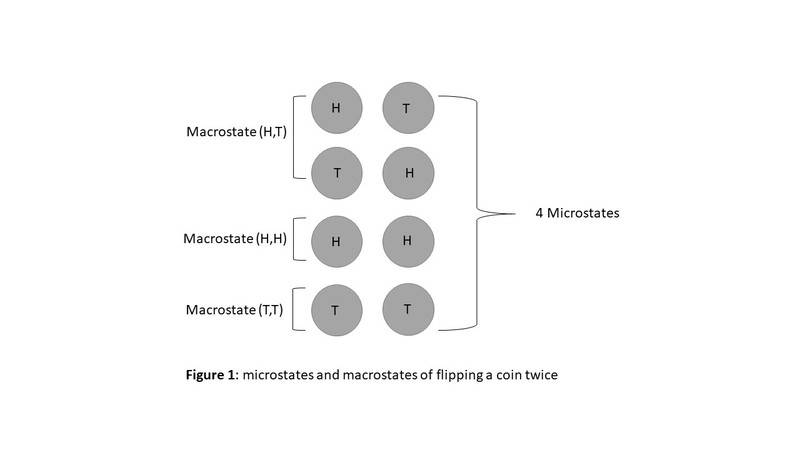

Doesn't the coin example from the same Wikipedia article that you linked help?https://en.wikipedia.org/wiki/Microstate_(statistical_mechanics)
With 32 coins, you have ##2^{32}## microstates, but still on one macrostate with all H and one with all T.
With gas in a room, the number of microstates is directly proportional to the number of gas particles. Now consider the thermal equilibrium macrostate and how many different ways there are to arrange those particles that satisfy that state.

Don't write off the coin example mentioned by @anorlunda too quickly. The coins have one degree of freedom with only two possible values (heads or tails) instead of six degrees of freedom with many possible values, but the logic is the same. A macrostate is something like "There are fifteen heads and seventeen tails" and a microstate is something like "coin one is heads, coin two is tails, coin three is...". Random shaking means we'll get a random microstate, but the odds heavily favor always being in a macrostate with roughly equal numbers of heads and tails.
