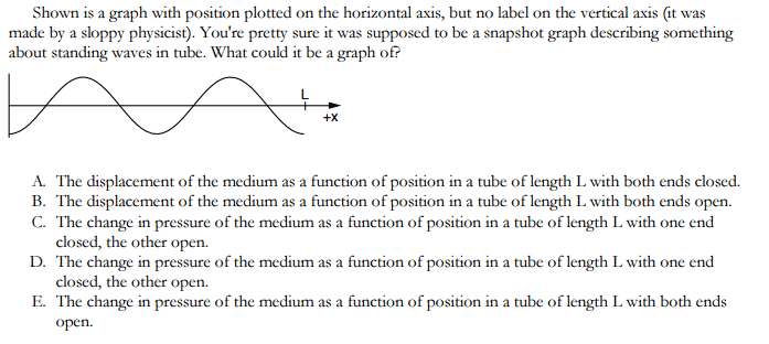

5)
1) I answered A, sound wave is a transverse wave so medium is displaced perpendicular to velocity of wave.
2) I answered A, since frequency doesn't change when a wave enters a new medium, so if lower index of refraction, the V increases and so does wavelength.
3) I answered C because you need light to pass through the lens to have an image in the first place
4) I answered C
5) I answered A
Sound waves are longitudinal, not transverse.
In 5, what sort of displacement (ie in what direction) did you have in mind? Can that displacement occur at the ends of the tubes, as the graph would indicate if it were a graph of displacement?
ok, i corrected number 1, should be same direction as the wave's velocity.
for 5, i imagine the wave in a closed tube to be longitudinal so displacement is parallel to the velocity. the displacement cannot happen at the end of closes tubes so the answer should be B then.
are the rest correct?
