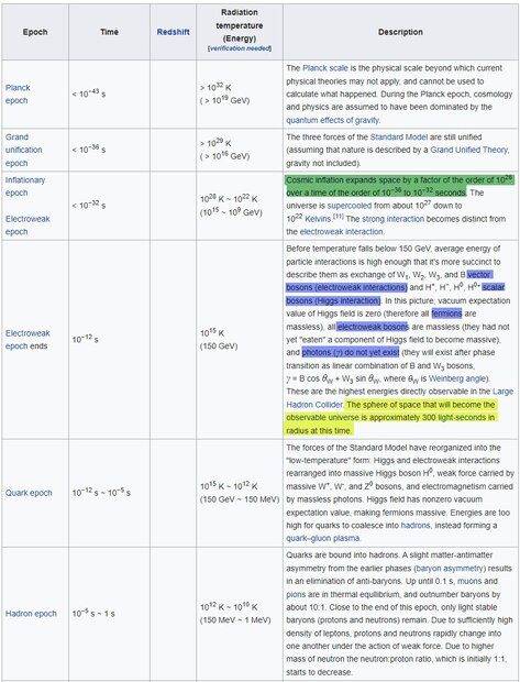

You can access the hi-res copy of the table here: https://photos.app.goo.gl/jS3apBR5gQ2SuDFv9
The copy of it is attached as well.
Table source: https://en.wikipedia.org/wiki/Chronology_of_the_universe#Tabular_summary
For the epoch titled "Inflationary epoch, Electroweak epoch" between 10^-36 to 10^-32 seconds, in green highlight it says, "Cosmic inflation expands space by a factor of the order of 10^26 over a time of the order of 10^−36 to 10^−32 seconds".
For the epoch titled "Electroweak epoch ends" around 10^-12 second, in yellow highlight, it says "The sphere of space that will become the observable universe is approximately 300 light-seconds in radius at this time".
This part has confused me a lot. As it is said the universe was infinite to start with, then the big bang happened everywhere. The visible universe is a subset of the whole universe. If the visible universe is compressed back, it would result into a singularity. Informally speaking at the time of big bang, such singularities were present everywhere in the universe. At the time of big bang, all those singularities exploded.
If the universe was really infinite to start with then how it can expand by a factor of 10^26. Is it infinity expanding by a factor of the order of 10^26?! If it's been estimated that it expanded by a factor of 10^26 then the size of universe at the beginning should have been known.

If you look under the column titled "Epoch" of the table, there is a row labelled "Electroweak epoch end" around 10^-12 seconds after the big bang. It seems like induvial particles such bosons and fermions started coming into existence around that time. I've highlighted the terms in blue.
The photons came into existence during the epoch titled "Quark epoch" which occurred between 10^-12 second to 10^-5 second after the big bang.
Do you think I'm understanding it correctly as a layman?

https://en.wikipedia.org/wiki/Expansion_of_the_universeNow using the table for two paragraphs below. Chronology of the universe: https://photos.app.goo.gl/jS3apBR5gQ2SuDFv9
For the epoch titled "Electroweak epoch ends" around 10^-12 second, in yellow highlight, it says "The sphere of space that will become the observable universe is approximately 300 light-seconds in radius at this time".What confuses me is that the radius of 300 light-seconds (or, diameter of 600 light-seconds) seems quite small. As it says above, "an expansion of distance by a factor of at least 10^26 in each of the three dimensions".
Let's check it. I'm going to use 600 light-second diameter for the observable universe.
600 light-second = 1.8 x 10^8 km
y x 10^26 = 1.8 x 10^8 km
y = 1.8 x 10^8 / 10^26
y = 1.8 x 10^-18 km
y = 1.8 x 10^-15 m
y = 1.8 x 10^-6 nm
For comparison:
radius of proton: 8.8 x 10^-16 m
diameter of proton: 18 x 10^-16 m
So, before the inflation, the diameter of observable universe was almost 1.8 x 10^-6 nm. Do you think I'm correct?Note to self:

As to question 5:
No. No layman is going to really understand that part correctly as doing so requires a quite advanced knowledge of quantum field theory.
It says at least a factor 10^26. It could be more. But you should not be surprised to find very small numbers here. It is in the nature of inflation.
