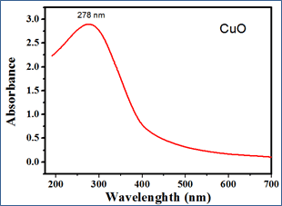

Let's say we have a CuO crystal, whose absorption spectrum is shown below. (Ref: http://jtasr.com/latest-articles.php?at_id=166 )
As we can see, it is highly absorbent in the middle-UV region. Let's say we are in a room which is illuminated with monochromatic red light. We then shoot a crystal of CuO at high velocity through the room.
So, if I understand correctly, one face of the crystal that is experiencing blue shifting of the red light, will at some point become absorbent to the red light. Light coming from the back of the crystal is red shifted, and passes through the crystal. Effectively, by shooting the crystal at relativistic velocities, we have produced a "diode" that selectively allows light through it depending on direction. Is this correct?
No. All it means is that the crystal experiences more reddish light impinging upon it from the rear and more bluish light impinging from the front. That doesn't change which frequencies it will absorb.
We see red light going through in one direction and not in the other direction.
We who consider the light to be red.

I think care is needed with reference frames. I believe the original context was omnidirectional red light in a frame where the crystal is moving. In the frame of the crystal, then, there is highly anisotropic light whose frequency and intensity is strongly dependent on direction.
In the frame of the crystal, it passes light from one side because the frequency is drection dependent and its absorption spectrum is not. In the "lab" frame, the crystal passes light from one side because the light is isotropic but the absorption spectrum of the crystal is direction dependent.
It's much easier to work in the crystal frame.
