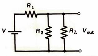

(1) We want to find the voltage across ##R_L##

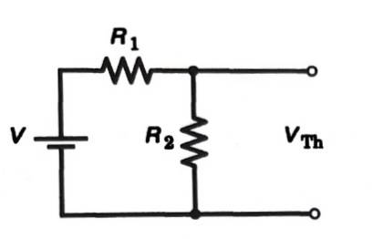

(2) We remove the load and label the terminals ##V_T##
(3) The equivalent network of (2)
So basically the voltage across the load is ##V_{th}## but when we find the equivalent network we put that same voltage behind a Thevenin resistance? Wouldn't that change the voltage across the load? Is the load in parallel with the Thevenin voltage?

First, thanks for an easy to read and understand question.
rtareen said:
So basically the voltage across the load is Vth but when we find the equivalent network we put that same voltage behind a Thevenin resistance?
No. The Thevenin voltage is found after the load is removed. When you find the voltage on the output terminals with the load removed, you are taking advantage of the fact that in the Thevenin equivalent circuit, there is no current flowing through Rth when the load is removed. So, in that case, the output voltage is equal to the Thevenin voltage because there is no voltage drop across Rth.
Yes, the voltage depends on the amount of resistance on the output terminals. The Thevenin voltage is defined as the voltage at the output with no load (∞Ω).
No. the load is in parallel with the series combination of the Thevenin voltage and the Thevenin resistance. Just as you have shown in the third schematic.

rtareen said:
What I'm trying to ask is how the circuit can work the same given that the voltage across the load is not going to be the Thevenin voltage, yet when we solve for the Thevenin voltage we are essentially solving for the voltage across the open load terminals.
I think you're getting confused by semantics. In your diagram 3, the voltage marked ##V_{th}##, I usually call ##V_{oc}## for open circuit. The voltage at the terminals, you marked ##V_{th}## in diagram 2. I like to call that terminal voltage. In any case, your two uses of ##V_{th}## are contradictory.
Likes DaveE
These are figures from the book. I didn't make these.
OK, then the two uses in the book are contradictory. Errors in textbooks are not unheard of. Sometimes, they even print lists of errata for textbooks.

So you're saying the voltage of the open circuit terminals is different from the Thevenin voltage? Then what is the Thevenin voltage? Let's say I've computed the voltage across the open terminals ##V_{oc}##. How do you get ##V_{th}## so you can reduce the network like in Figure 3 of OP?
I think what he's getting at is it is a different voltage because it's in a different location. But, in the no load case, it happens to have the same value as Vth in the Thevenin equivalent network.
He is absolutely correct IMO. You will find it very confusing if you mix up names and values when you are working with circuits. Naming things, like Voc, or Il, is somewhat trivial and arbitrary. Finding the values and/or relationships between them after that requires precision.
This is especially important when you are working with equivalent circuits or simplifications. In this case, the Thevenin equivalent circuit is a great simplification for how the circuit interacts with the load. But, in the process, you have lost information about what happens inside the network, for example the current through R1; this is the price to pay for simplification.

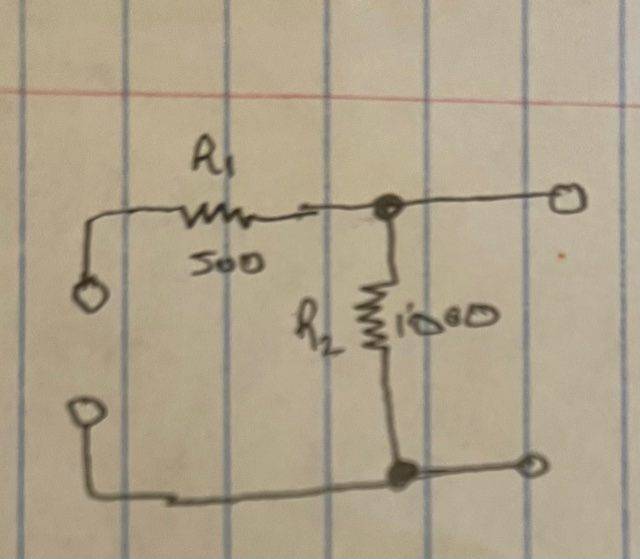

I'm having another problem now. How do you find the equivalent resistance when we have a current source instead of a voltage source? I attached a screenshot of the problem (6-5) which uses Figure 6-18. We replace the current source with an open circuit, but the equivalent resistance should be ##R_{th} = \frac{500(1000)}{500 + 1000} = 333 \Omega##, right? Why are they saying it is 1000? Does it have to do with the fact there is an open circuit?
After you have replaced the current source with an open circuit, what is the current through the 500Ω resistor? Where would that current flow? Draw the schematic with the current source removed.
Here's my drawing with the current source removed. Without the current source there is no current throughout the entire thing. However, the only thing I can think of to justify the answer is that if current were coming from the load, then that current would only go through R2.
Yes. Current can only flow through R2. So R1 can have no effect on the circuit. You would get the same answers if R1=500Ω, 1KΩ, or 100KΩ, so you can remove R1 also. You could also think of finding the total resistance of the circuit branch with R1, it's in series with ∞Ω from the current source you removed, so 500Ω + ∞Ω = ∞Ω.
When you find Rth by calculating the resistance seen from the output port, you are really, conceptually, applying a voltage to the output port and finding how much current would flow. For example, think of measuring the resistance with an ohm-meter; that is exactly what those meters do. That ohm-meter will only see current flowing through R2.

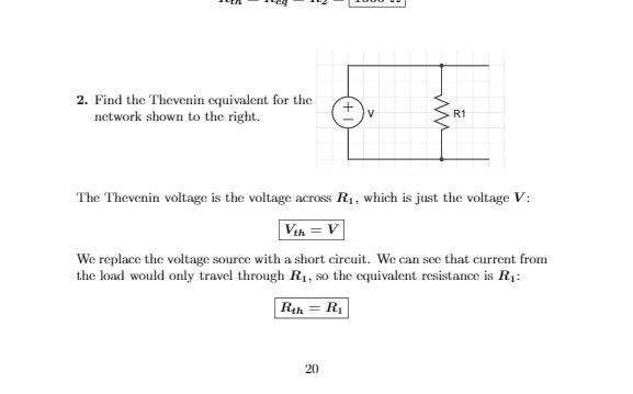

Hi DaveE.
Thanks a lot for your help. I'm actually self-studying right now from the book. Can you check my answer to problem #2? It seems to simple for this to be the right answer (these are my latex notes). This should be my last question on this topic

I personally think that one is incorrect.
Just for the sake of checking if I were to put ##R_L## there, then the voltage across ##R_L## would be ##V## and the current going through it would be ##V/R_L##.
If I were to say that ##V_{th} = V## (which I agree there) and ##R_{th}=R_1##, then what would happen if I replaced that circuit with the "Thevenin equivalent" circuit and attach it to ##R_L##? Now the voltage across ##R_L## would be a voltage divider and the current going through it is ##V/(R_1+R_L)##. That doesn't look right to me.
I think ##R_{th}=0##. If ##R_{th}=0##, then when I replace that circuit with the Thevenin equivalent and connect ##R_L## the voltage across would be ##V## and the current going through it would be ##V/R_L##. That's what I was expecting. Sometimes I struggle with the kind of inspection method to get ##R_{th}##; so: I sometimes short circuit the output and get the current going through that, then I say that ##R_{th}=V_{oc}/I_{sc}##. The reason I got ##R_{th}=0## is because when I try this approach I get ##I_{sc}=\infty## and ##R_{th}=V/\infty = 0##.
edit:
Funny enough... in their description... if you replace ##V## with a short circuit, then none of the current would want to travel through ##R_1## because it would all travel through the short circuit ##0 \Omega## wire.
edit:
Will that method always work? ##R_{th} = V_{oc}/I_{sc}##? I need a standard way to always do this kind of problem.
By the way, the book says that the Thevenin resistance is the resistance "looking back into the output terminals". But they never explained what that means. This is a really old book that only had one edition but for some reason my university likes to use it for this electronics course.
That's how my professor taught it to me and it has been working for me :)

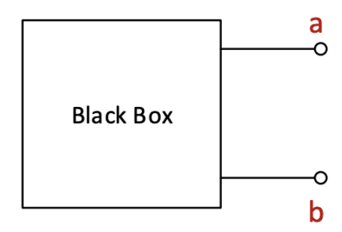

Let's just assume that Thevenin's theorem is correct. Then whatever network you have can be represented by the 3rd schematic in the OP; a Voltage source Vth in series with an impedance Rth.
Then what is the open circuit voltage, Voc? Since there is no current flow there is no voltage across the resistor so Voc = Vth.
What is the short circuit current, Isc? All of the voltage is across Rth, so it must be Isc = Vth/Rth = Voc/Rth. Thus Rth = Voc/Isc.
Both of these measurements are made at the output terminals, so it doesn't really matter what is "inside" the network connected to those terminals, as long as it is made of linear components (i.e. Thevenin's theorem is valid).

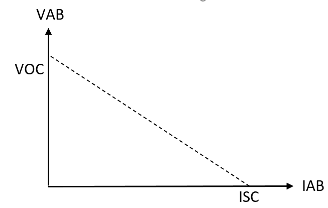

I wish the textbooks would teach it the simple way. You have a black box with two terminals. You don't know what's inside the box, but you're told it is linear.
So what simple and universal experiments could you do using only the terminals? Measure open circuit voltage VOC and measure short circuit current ISC. Then draw a straight line between them (because it's linear).
The simple circuit with voltage VOC in series with resistance ##\frac{VOC}{ISC}## draws the same straight line, and is therefore equivalent. There can be other equivalent circuits, but this is the one we call Thevenin's Equivalent.
There is no need to define any other confusing quantities, VTH, ITH, RTH.
Thevenin's Theorem takes more math to prove that this simple procedure is always valid. But the theorem should not be confused with the simple procedure to find the equivalent.
