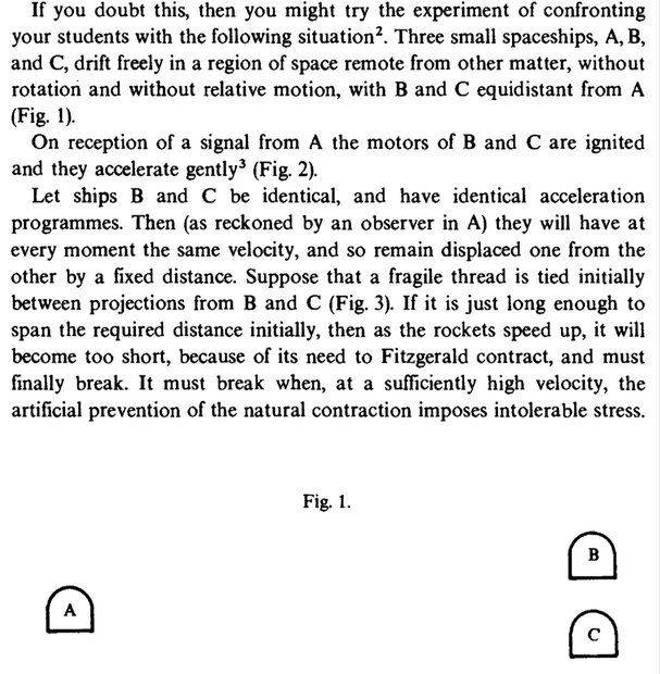

Doing a small change in the statement of the Bell's paradox - to consider engines with constant and same F/M ratio (F is the propulsion force), instead of a constant and same proper acceleration, I think that string does not break (is my own conclusion, not being an expert in SR).
Thinking about Bell's string paradox , I understand that if both spaceships maintain the same and constant proper acceleration, the string breaks because of the non-simultaneity of the acceleration effects at both ends of the string.
But I want to introduce and consider a slight and subtle change in the statement of the original Bell’s paradox, as follows:
Where the statement of the Paradox reads that both spaceships keep the same and constant proper acceleration, I consider instead that the spaceship engines keep a constant and same F/M ratio (where F is the propulsion force). So, it's no longer the Bell's string Paradox, although at the first glance seems the same thing.
My experience is that people don't usually get the point of what this change means, and argue that it's just the Bell's scenario, so string breaks, and there's nothing to discuss about. But, it's not the Bell's scenario.
What follows is the conclusions I get, based in my limited SR background during University studies, and some online courses about the subject now that I'm retired. Don't take it too seriously.
Lets consider that both spaceships depart from their initial parking position in space, and after 1 minute proper time at leading spaceship S2, both spaceships have reached the nominal 1g=9.8 m/s2 acceleration, and the engines are set to their nominal F/M ratio, that is kept constant and will not change thereafter.
At 1 hour proper time at leading spaceship S2, the string, that until now was allowed to extend - but not to runaway - from S2 to S1 keeping a zero tension at hook point in S1, is progressively stopped from further deployment. Considering an initial proper cable length of 10 Km at that proper time (according to S2), I get the following results using the constant proper acceleration coordinate equations, and considering the line of simultaneous events for the observers:

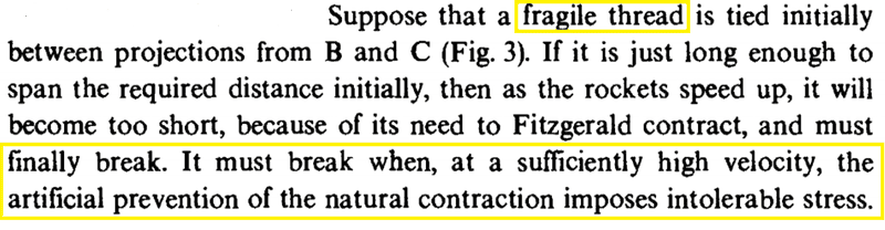

How does this differ from constant proper acceleration?
I don’t think that’s right…. I’ve always seen it described as both spaceships maintaining the same coordinate acceleration, as measured in the frame in which they are initially at rest (although it works with any inertial frame - just harder to specify the initial conditions).
Likes Dale
It is. The proper acceleration of the two spaceships in the Bell spaceship paradox is identical. That is what makes the string between them stretch and break (as opposed to spaceships in Rindler motion, where the one in front has smaller proper acceleration than the one in back, which is what allows them to maintain constant proper distance from each other so a string between them will not stretch).
In more technical language, the expansion scalar of the Bell congruence, the set of hyperbolas with constant proper acceleration and a common "pivot point" (meaning they are all at rest in the starting inertial frame at the same instant), is positive, while the expansion scalar of the Rindler congruence is zero.
Not quite. They start out maintaining the same coordinate acceleration, but in relativity it is impossible for an object to maintain the same coordinate acceleration in a given inertial frame indefinitely.
This was discussed in another forum https://www.thenakedscientists.com/forum/index.php?topic=85475.0
The scenario seems to be that the two ships maintain constant acceleration, but with the lead ship reeling out the string as needed. After a while (a day at 1 g?), the brakes is put on the reeling out and additional tension develops on the stretching string, accelerating the rear one more than 1g, and slowing the lead ship. It bounces rather than breaks (the bouncing being what the python code simulates). The speed is slow enough that speed of sound through the cable is not considered.
I apparently offended the OP by questioning whether this was a pure thought-experiment or if practical matters were to be considered (such as finding a ship that can accelerated for an entire day with the precision needed to detect a few mm/hour of string contraction after about 850 km/sec of delta-v)
Constant coordinate acceleration is only possible for finite time, and is frame dependent. At 1g, one can only maintain constant coordinate acceleration for almost a year, with the proper acceleration increasing the entire time. Before the coordinate year is up, the proper acceleration hits infinity and the coordinate acceleration must halt.
But yes, for that finite time, a string between a pair of ships under constant coordinate acceleration will also break.
If F/m is the same then a is the same also and this is standard Bell’s paradox. Nothing you have described to this point distinguishes this one from the standard one.

PeterDonis said:
Ah, got it. Yes, in the standard Bell spaceship paradox the coordinate accelerations of the two ships, in the inertial frame in which they start out at rest at the same instant, will always be the same.

Nugatory said:
I’m sorry, that was intended to be read as “the same coordinate acceleration as each other”, not unchanging coordinate acceleration which is of course impossible.
To quote Bell: “[the two ships] will have at every moment the same velocity, and so remain displaced one from the other by a fixed distance”, a frame-dependent description using coordinate velocities and frame-dependent simultaneity and distance. And to make it so the coordinate accelerations in the frame in which the separation is fixed must be the same at the same time for both ships.

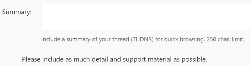

Ibix said:
Exactly. So why the huge long post?
The exact version of my formula is ##\delta g=\frac{g^2l}{gl+c^2}##, as you can easily verify. Rearranging it to match your version of the Born rigidity criterion is then trivial algebra.
Is such a "huge" post because I though is the policy of the Forum (not to do a huge post, but to include all relevant information), and because 80% of the size if due the inclusion of the Python code, and a little of theory for accelerated bodies that I used for the program which of course, is not intended for you to read, who already know all that details. And for that very same reason, those parts are put at the very end of the post.
As for the formula, you're right, it's the same, sorry.
But take into account that for saying "the spaceship goes into the Born rigidity condition", first you have to somehow prove that the spaceship can indeed go to the Born rigidity condition, is not that easy.
Most of the information is irrelevant. And the relevant information is then obscured simply by being buried several paragraphs deep in the irrelevant information.

Dale said:
but it is the finite tension that the string provides that makes the difference in the scenario.
Is the Bell's scenario, the thread in the Bell scenario breaks due to "intolerable stress". I don't understand, now it's me that it's not getting what are to trying to highlight. ¿?

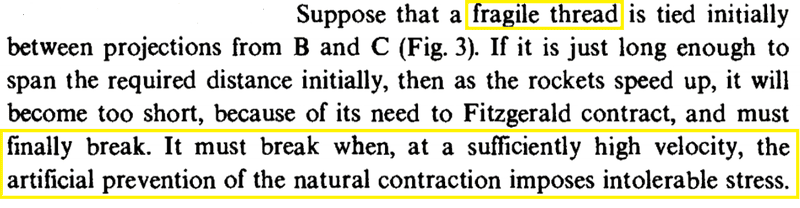

Dale said:
By burying that fact several paragraphs down in your description you make it likely that people will miss your point.
Could you please point me what is the exact paragraph you are referencing? If it's so, was not my intention to hide anything to trick people... I'm not so naive, and pretend to write in the fine print, at the end, something to trick anybody... I'm not an insurance company representative.
I'm not putting into the "alternative scenario" anything that was not previously in the Bell's paradox itself. The only difference is what I write in the preamble of the post, nothing else hidden:
"Doing a small change in the statement of the Bell's paradox - to consider engines with constant and same F/M ratio (F is the propulsion force), instead of a constant and same proper acceleration, I think that string does not break (is my own conclusion, not being an expert in SR)."
That's not a very polite comment, by the way. I think this is not in the guidelines of the forum.

Lluis Olle said:
And, is Bell itself who introduces, not a string but a thread, into his paradox, and a "fragile thread", so he's talking about certain ambiguous characteristics of the thread.
The statement “fragile thread” is not ambiguous. It means a thread with a negligible ultimate or breaking strength. Just as “smooth” means negligible friction, and “flexible” means negligible bending stiffness, and “light” means negligible mass. All of these are standard terms with unambiguous meaning. The thread being fragile indicates that we can neglect the tension in the thread compared to the other effects in the problem. I.e. the tension force is taken to be 0 in Bell’s formulation. There is nothing ambiguous about his description of the string as “fragile”, but it differs from yours as your string can sustain a non-zero tension and therefore is not “fragile”.
Yes, for a “fragile” thread any non-zero stress is “intolerable” and it breaks.
Yes, you are. You are putting in a non-fragile string. That is the key difference.
By Newton’s 2nd law Bell’s assertion that the accelerations are equal means that the net forces are equal. With a fragile string, the tension is 0 so the net force on each rocket is equal to the thrust. Thus, with a fragile string, you asserting equal thrust is the same as Bell asserting equal acceleration.
It is only with your additional change to a non-fragile string that the tension force is non-negligible, the net forces differ, and therefore the accelerations differ. This additional change is therefore essential to your analysis of the scenario and should be explicitly stated in the initial statement.

Just to do some recap and not get lost, because part of the discussion has been in another thread about the Born rigidity, and IMHO:
The summary, to avoid any confusion, should read:
"Doing two changes in the statement of the Bell's paradox: to consider spaceship's engines with constant and same F/M ratio (being F the propulsion force), instead of a constant and same proper acceleration (as is deduced from the Bell scenario), and a real string with a weak ultimate tensile strength, I think that string doesn't break (is my own conclusion, not being an expert in SR)."
Then, an excerpt of the original Bell's statement should have been quoted as a reference:
"Suppose that a fragile thread is tied initially between projections from B and C (Fig. 3). If it is just long enough to span the required distance initially, then as the rockets speed up, it will became too short, because of his need to the Fitzgerald contract, and must finally break. It must break when, at sufficiently high velocity, the artificial prevention of the natural contraction imposes intolerable stress".
Then, I should had to comment that "fragile" in the Bell's sense means that the string has really no ultimate tensile strength, and so, will break at any tension. And then, for this alternate scenario, remark that I do consider a real string, although with a very weak ultimate tensile strength in relation to the scale of the mass of the spaceships.
I should have made clearer why is the constant F/M ratio considered in this alternate, not Bell's, scenario, and perhaps include some link to an example to show what it means.
