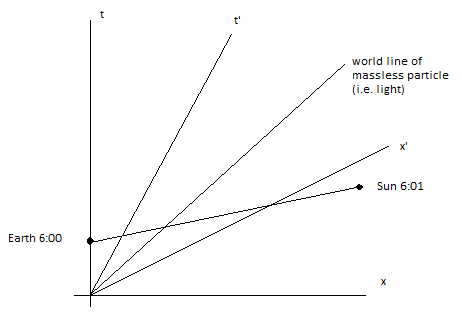

You're right. However, in a coordinate system that's comoving with someone going fast (but <c) in the direction towards the sun, the same sequence of events would be described very differently. I think a spacetime diagram is the best way to explain it. I drew this one in paint, so it's ugly (and not 100% accurate, because the lines don't have the right slopes), but it illustrates the main point well enough.
The t and x axes are the ones used by the observer on Earth. The points on a line that's parallel to the x-axis all have the same t coordinate. The t' and x' axes are the ones used by an observer whose motion is described by the t' axis. The points on a line that's parallel to the x' axis all have the same t' coordinate. Note that it's possible to draw a horizontal line in the diagram below the Sun 6:01 event and above the Earth 6:00 event. This means that the Sun 6:01 event has a later t coordinate than the Earth 6:00 event. But the Earth 6:00 event is above the x' axis, while the Sun 6:01 event is below the x' axis. This means that the former has a later t' coordinate than the latter.
So in the "primed" coordinate system, the thing you think of as going from the Earth to the sun is described as going from the Sun to the Earth. Alternatively, it can be considered going from the Earth to the sun, but arriving before departing (i.e. going back in time).
Edit: I have to add that it doesn't make sense to use a person in the example, because a person moving FTL contradicts SR. So SR plus your assumption is logically inconsistent, and in an inconsistent system, every statement is true (including things like 7=3). It never makes sense to ask what would happen if something that contradicts the theory we're supposed to use to answer the question is true. But it's fine to ask what happens if some weird-*** particle makes this trip, because that doesn't immediately contradict SR. (Apparently we can't say "***". I didn't know that).

Do I read Fredrik's diagram correctly if I conclude that the fast-moving observer will see the "FTL" ship moving backwards, but due to the distances between Earth and sun and the observer moving slower than light it could never interfere, fr. ex by first seeing the ship leaving (backwards) the sun and then sending a message to tell the ship not to start the journey in the first place.
Oh, this is hard to put to words, but my point is, is there some kind of difference between a scenario leading to a paradox where an observer would observe an effect leading to a cause (=time going backwards) but not being able to interfere due to the limits of lightspeed, and an observer being able to either contact his own past, or convey a message from the sun to Earth backwards in time?
Are both scenarios "equally impossible?"
The world line of the "fast-moving" observer is the t' axis. As you can see, it intersects the world line of the FTL object. So they actually meet at that event, and can do things to each other. Suppose e.g. that a short time before that event, the "fast-moving" ship drops an empty fuel tank or something, that collides with and destroys the FTL object. This would eliminate the part of the FTL object's world line that's to the right of the explosion event, not the part that's to the left. From the fast-moving ship's point of view, this is what happened: It dropped a fuel tank, which subsequently exploded, and out of the explosion came an object that was moving FTL towards Earth.
