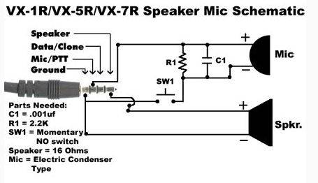

PS there is some unusual wiring in the PTT that I don't fully understand, I'll provide a schematic from Yaesu.

I think maybe you have used a jack socket with an in-built shorting switch.
Thanks for taking the time. I'm struggling on with this today. I don't know how I would check if it's a shorting switch/jack on the connection, it is an audio cable extension through only a 3.5 mm one. How would I check to see if it is?

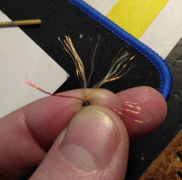

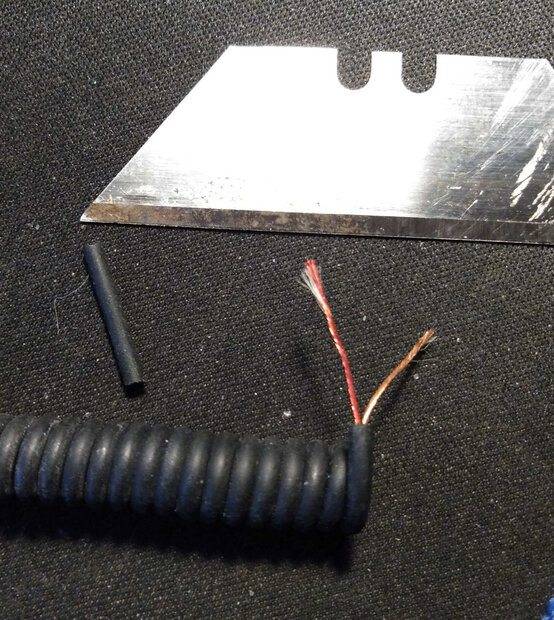

Thanks for taking the time to help with this. I'm back at it today. The wire from the PTT attachment on the hands-free kit is 2mm with two tiny cores, about 0.4 mm, one red and one copper coloured. I've got bits of other cables like this that I've salvaged mostly from old audio kit like headphones.
These wires all have three cores, red, green and copper. The wires have some kind of insulation so I try to burn it off before starting the splice. I hold a lighter to the end of the wire and it burns for a moment then goes out, stripping the colour off that section.
The wire on the hands-free kit and the other ones I have don't have a bundle of synthetic cord between them, I know what you mean I've seen it before on other wires. It is there on these too, under magnification I can see synthetic fibres mixed up in the soldered joints. Each core has this synthetic cord in the middle and the copper is wound around it. To prevent pinching I guess.
If it is copper. I wind the splice together then heat and run solder through the joint but as you say very little is staying in there. enough to fix it in place but barely. I'll look into the crimp idea today. There must be a way to splice these together.
If you have the patience, you can unwind the the Copper from the fibers then cut off the fibers. From a practical standpoint, it is sometimes easier to unwind the fibers from the Copper. Separate them at the end then unwind whichever is more convenient.
The approach of burning off the insulation or fibers contaminates the surface of the Copper so solder will not stick to it; cut the stuff off instead. The Copper should be shiny; if it isn't then gently scrape it clean with a knife blade (or a fine wire brush or fine sandpaper). If you are in the US, it should look just slightly darker than a brand new penny.

It did help
Success, after two days of struggling I worked it out with help from you guys, in particular Tom in the last post pointed out that burning the wires was coating them in a residue that made it harder for the solder to stick. This and his advice to separate and remove the synthetic fibres sent me down the road that solved the issue
I can solder, I'm no pro but I've not been not failing for want of skill, though I've not soldered anything this fine before.
I unwound each core and separated the synthetic fibres as advised then cut them away. Each core is made of a dozen or so individual strands of copper and each strand is coated, these stands are thinner than a hair so mechanically removing the coating would not be practical.

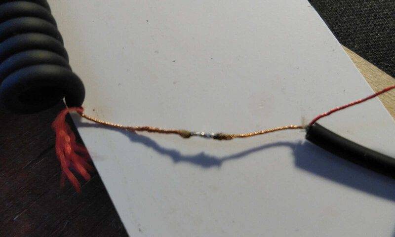

I spliced two cores together winding the wires around each other with the coating still on.

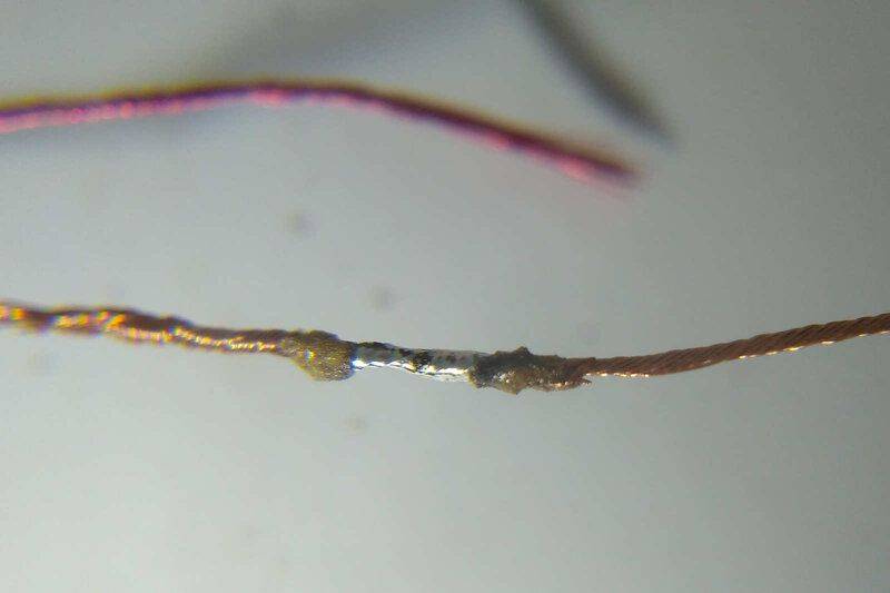

Then I balanced a drop of molten solder on the end of my iron and held the iron so the splice was suspended in the drop of solder. After a few seconds, the wires heated to a point where the coating melted away and the solder instantly wicked into the joint. I then immediately removed the solder drop. If I held it there a second too long the solder wicks back out into the drop. I had to practice a bit to get it right.
The black cable shown is 2mm in diameter and the splice less than half a mil.
In this picture with magnification, you can see how the coating has melted and pulled back on either side.
