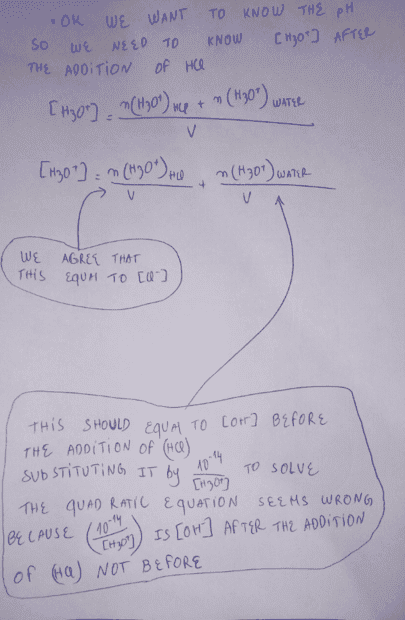

Hello , the problem that i refer to is present when we try to calculate the pH of a solution without any assumption.
in a lecture entitled "calculating the pH of a strong acid/base solution " after adding a certain amount of HCl in water we are asked to calculate the pH
(the amount of HCl and volume of water is known )
*to calculate the pH we need to calculate [H3O+]
*we have 2 sources of [H3O+] in this solution
-first the [H3O+] from HCl
-second the [H3O+] from the dessosiation of water
we know that [H3O+]from HCl=[Cl-] because HCl is a strong acid
and we reffered to the [H3O+] from water as [OH-] ( here is the problem but we'll come back to it later )
using Kw we replaced [OH-] with (10^-14/[H3O+])
now we have this equation [H3O+]=(10^-14/[H3O+]) +[Cl-]
and the professor said that all we need to do is to solve the quadratic equation

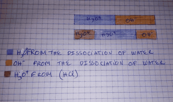

here is the problem it seem that the two [H3O+] are not the same unknown ( the amount of [H3O+] from water do not equal to (10^-14/[H3O+])) , here is a plot

There is no such thing as two different H3O+ concentrations in the solution. All H3O+ look the same and participate in the same reactions, there is no way to say where do they come from, so in every equilibrium and every mass/charge balance only the total concentration matters.
There are specific cases where expressing the total as a sum of concentrations coming from different sources is a neat trick helping in calculations, but this one here is not one of them.
The dissociation of water is usually so insignificant that it is neglected, with the exception of very dilute solutions.
The solution that the OP @samy4408 presents sets the positive ion concentration equal to the negative ion concentration to balance the charge. The result with a little algebra is a quadratic expression for the ## [H^+ ] ##. You can then solve for ## [OH^-] =10^{-14}/[H^+]##, and oftentimes it will be so much less than the ## [Cl^-] ##, that it can be ignored, and the quadratic solution is unnecessary. In that case, ## [H^+] \approx [Cl^-] ##, (where we began with ## [H^+]=[OH^-]+[Cl^-] ##).
@samy4408 -- Please learn to use LaTeX to post math equations, and type your work into the forum window. Your images in the post above are basically illegible to me. The "LaTeX Guide" below the Edit window is a good place to start. Thank you.

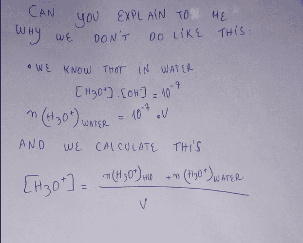

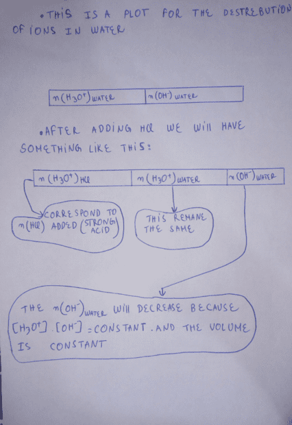

Hello , i understood my misconception about the concentration , the following is a reformulation of my problem : sorry i tried to use latex but i found it less comprehensible than this
You don't even need LaTeX. If what you see on your screen is the same as on mine at the top of the posting form symbols for getting subscripts and superscripts, on far right a button for seeing what the result will be - all you need here.
As far as I can make out you are still thinking about two separate H3O+ types that belong to themselves separately.
Also you are only using two (the equilibrium constant expressions) of the three equations you would need to solve the problem completely exactly. The one you are missing is the one that expresses electroneutrality of the whole solution.
Write out also the formula for that and you may find that you are led to a correct solution and way of looking at it.
hello , thanks for your replay .
finally i found the answer for my problem , it's just about le Chatelier's principle when we add HCl , [OH-] decreases by reacting with H3O+ to form H2O
so H3O+ native to water also decreases , then it makes sens to solve the quadratic equation .
Likes Charles Link
Yes, that's a direct result of what I wrote earlier - there are no "different" ions of the same kind - all H+ is involved in every reaction.
There are some other problems with what you wrote, but they are impossible to quote. For example, you wrote "we agree (this concentration of H+) equal [Cl-" - but we don't, for the same reason. There is no such thing as "this concentration". If anything, we can agree that
[tex][H^+] = [Cl^-] + [OH^-][/tex]
which just means solution is electrically neutral (this is so called "charge balance equation").

Quadratic equation becomes a must for diluted solutions, at some point if you ignore water autodissociation you are getting pH over 7 for a diluted acid solution, which is an obvious nonsense. Yes, such diluted solutions of strong acids have no much practical importance.
