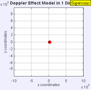

Excellent website with video examples showing why sonic booms occur.
http://www.acs.psu.edu/drussell/Demo...r/doppler.html
When I show this to someone not especially science literate, I skip all the math and tell them to visualize (soundulize? LOL) that each expanding circle represents a single ring of a bell. In other words, pretend there is a person ringing a bell on the airplane at a steady rate.
Then place your finger on the video anywhere you want and say "ding" every time a circle hits your finger.
In the first example you hear the bell, ding, ding, ding, ding, no matter where you put your finger (except right on the dot, of course) just like you would expect and just what it would sound like on the plane.
In the second, if your finger is directly above or below the dot and to the right, the dings come closer together than in the first example (forget mentioning the frequency change or you'll lose them). If you put your finger to the left, the dings are farther apart than the first example.
Then I tell the person to imagine the airplane going faster and faster - the dings will come closer and closer together, until you get to the point where it no longer sounds like single dings, but rather a continuous noise.
Then I move on to the third picture and repeat - put your finger above or below just to the right of the dot and count the dings - you get a bunch of them all at the same time, after which you hear dings again. Voila! that's a sonic boom - lots of dings all added together to make one loud ding.
The fourth example explains the bullet past the head phenomenon. Place your finger very slightly above or below and to the right of the airplane and you can see that the "Mach Cone" passes by, NOT the added together dings. Place your finger lower or higher and to the right and you then get the sound summation.
Then I explain the double sonic boom by pointing out that the video only shows sound coming from the back of the airplane, when in reality sound is generated simultaneously from the front shock wave AND the rear shock wave and there is a considerable distance between the two sources of sound (The bell ringing analogy no longer works very well) so you have two summed sounds a fraction of a second apart instead of just one.
