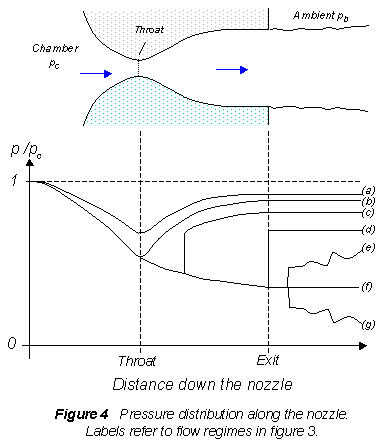

T C said:
OK. I make it further simple. When the flow remains within the subsonic level, the pressure doesn't increase but rather decrease. But when the velocity reached (or can reach sonic level) inside the convergent nozzle, do the pressure increase inside?
In a CD nozzle supporting a supersonic exit, the pressure decreases throughout the entire length. See scenario f:
