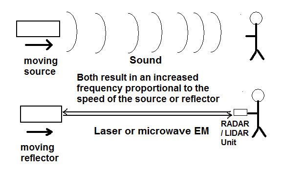

davenn said:
If the sound source is moving and the observer is stationary or the opposite … moving observer and stationary sound source
the effect is the same
ohhh and that is the same for light or any other EM radiation ...
Are you not thinking solely of EM waves?
I thought it was generally recognised that there is a clear difference for waves dependent on a medium such as air.
Sound or EM
As far as I'm aware, the Doppler "effect" is the same, tho the process is slightly different ... medium/no medium
edit ... ohhh and as an afterthought ...
And of course, you can do the same thing with sound as what is being done in the lower section of the image with the laser/microwave radar :smile:
There are obvious differences if one of you travels faster than the speed of sound (which is why you don't have to worry for EM waves).
Source approaches > SoS, you don't hear anything until passes, then you hear lower f as it moves away.
You approach stationary source at > SoS, you hear raised f until it passes, then nothing more.
Otherwise there are quantitative diffs.
