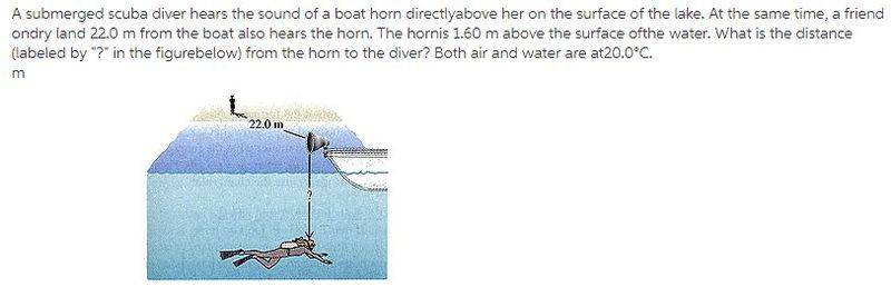

Sound Wave Problem -- time of flight in air versus in water
In summary: I drew a diagram. Any did some analysis on this what i observed was the followingThe wave front traveling from the surface of the water has to travel an additional 22m before it reaches the person on the ground.
Selfless_Gene
v = d/t
Solve for t. t = d/v
In my General Physics 2 course we are doing sound waves I have the answer to the problem which is 90.8m I am trying to understand the concepts of sound wave. So please correct me if I am wrong,
1. The sound from the horn is propagating as a longitudinal wave in all directions.
2. The Diver and and the person on ground hears the sound at the same time. Does this mean we can use this equation t=d/v because the time is the same for both the diver and the person on the ground?
3. I am unsure of the math behind this problem.
It depends how you are using that. Note that the sound to the diver travels through two different media and the velocities are different. You need to look up what those velocities are.
You are not told the height above water of the ears of the person on dry land, so take the 22m as their distance from the horn.

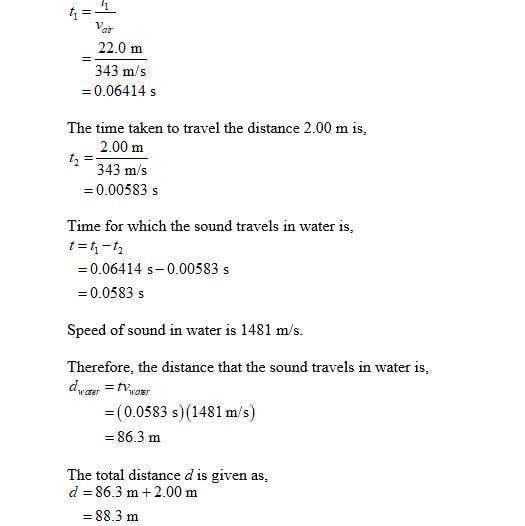

So when I subtract the time t2 which is the time the sound of the horn hits the surface of the water by t1 which the time that the sound of the horn reaches the person on the ground. This can tell me the time the sound travels in the water? I don't understand this portion of the problem its in the picture below listed as t1-t2 time for which the sound travels through water. I don't understand the relationship and how can subtracting t1-t2 tell us the time the sound travels through the water.
When the wave front that heads down from the horn towards the diver reaches the water, how far has the wave front traveling horizontally to the land gone?
(And how did 1.6m become 2m?)

This is the same problem just with different values. I don't understand what you mean by the traveling wave front. The sound wave is propagating in all directions. The wave travels from the horn to the surface of the water which is 1.6 m and horizonally the same wave front also travels 22m to the horizontally.
You can think of it either way. The question is the same. When it reaches the surface of the water, how far has it still to go to reach the person on land?
the distance it has to travel is 22 m since the person on land is is 22 m away.
That's the total distance from the horn, but that is not what I asked.
Draw a diagram, showing the whole wavefront when it first touches the water. How much further does it have to go to reach the landlubber?

I think I am understanding better because you mention concentric circles the waves will go directly to the person the ground from the horn. Correct me if I am wrong but the total distance the wave traveling in the air is 23.6 m, then the wave touches the water after this distance. I don't understand why we have to do t1-t2 = the time wave travels in water. Wouldn't it be t1+t2?
No.
As I wrote in post #2, we do not know the height of the person's ears relative to the horn, so you will have to assume they are at the same height. The sound that goes from the horn to those ears will take a straight line, so it is 22m.
Draw a horizontal line from horn to ears and label it 22m.
That sound leaves the horn at the same instant that it also sets out straight down towards the diver. At time t2 the sound reaches the surface of the water. To represent the wavefront at this instant draw a circle centred on the horn and touching the surface of the water. What is the radius of this circle?
As the part of the wave entering the water continues down to the diver, the part moving horizontally continues towards the land. How much further does it have to travel to land after time t2?
One way to do this is to set it up as two equations with equivalence.
Both observers hear the sound at the same time.
Therefore, the mtine to Landlubber equals the time to Diver.
TL = TD
TL is easily calculated.
TD is the sum of the time in air (easily calced) and the time in water (has one unknown).
Solve for the unknown.
