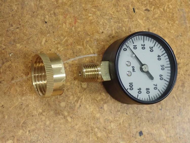

The owner's manual will also tell you the minimum incoming water pressure. Is there any place that you could put in a pressure gauge to check water pressure with and without the shower running?

I think it is obvious the pressure is too low, there is nothing to investigate. Just tell me if the pressure will rise with a bigger pipe. Or will it fall because the existing strangulation raises it?

The cap fits a water hose connection. All necessary parts are in your local hardware store. Drill and tap a hole, screw in the pressure gauge, add a hose gasket, and screw the assembly onto the water hose connection on the outside of your house. Measure the pressure with and without the shower running. Look for a hose connection near your water heater, and measure again. There may be a hose connection on a utility sink faucet. Measure there. After that, reread posts 2, 5, and 7 in detail. Then come back.
I have a solid background in fluid flow, and it is not obvious to me. Nor is it obvious to other posters on this thread. This is not the time or place to write a book, so the short version is that if you replace a length of pipe that is not your bottleneck with larger pipe, you will not increase your pressure. Nor is it obvious that you have a pressure problem. That's why we are asking for some simple, low cost tests.

If possible, measure the inlet pressure at no-flow and normal flow before concluding low pressure is at fault.
