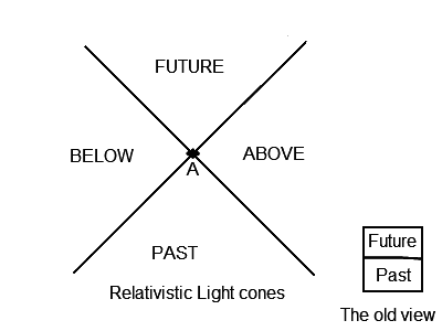

Why does this mean "below"? Inside the event horizon, negative r is a future-directed timelike coordinate. What I quote above thus means that the light is received after it is emitted, as it should be.
I would visualize "above, below, future, and past" in terms of light cones, as in the large diagram below. This is assuming you are talking about what an observer at any given point would perceive in his or her "local frame". He'd perceive things in terms of his or her light cones, which would maintain 45 degree angles on the Kruskal-Szerkes chart because that's a feature of the chart.
This diagram certainly works relativistically in flat (Minkowski) space-time, as I hope you'd agree?
I've sketched the "old" outdated, non-relativistic concept of future and past in the corner, as an afterthought.
There are two issues here:
1) Use the "new" viewpoints (large diagram) not the old (small diagram).
2) r and t interchange roles as being space-and time coordinates. So in the inside horizon, if two events happen at the same r-value and different t-values, they are separated in a spacelike manner - one is "above" and one is "below", they are separated in a space-like manner.
