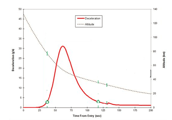

I was given the following drag profile for a spacecraft upon reentry. I understand that the moment it enter's Earth's atmosphere it will be accelerated due to gravity and pick up speed which in turn increases drag however I don't understand why drag then decreases.
Wouldn't density cause drag to keep increasing since density increases the closer you get to Earth's surface? The end makes sense because the object would reach terminal velocity thus drag should equal 1G but I just don't get why drag suddenly decreases after 70 seconds since velocity and density would still be increasing after that point.
What makes you think that the velocity increases after that point?
Since it hasn't hit terminal velocity, velocity should still be increasing (although not as quickly as before since it's decelerating) until terminal velocity is acquired which isn't till ~150 seconds. What am I missing?
It is approaching terminal velocity from above. Its speed is decreasing toward terminal velocity. [Pretending for the moment that "terminal velocity" is a single fixed speed in this scenario].

Hmm, what causes the speed to decrease though? Wouldn't drag itself still increase due to the increase in density as you approach the surface?
Drag
Drag is a function of speed too, not just density.

A.T. said:
DragDrag is a function of speed too, not just density.
Ok I think I'm starting to get it. The peak is pretty much the point in which velocity will start to decrease towards terminal velocity. However why does a spacecraft start at a speed higher than terminal velocity?
(I'm using to thinking objects speed up to terminal velocity, but can't think of how the spacecraft would start above terminal velocity since it's floating through space with no acceleration before it enters the atmosphere)
The point when drag exceeds one gee is the point at which velocity starts decreasing. The spacecraft starts in low Earth orbit at around 18,000 miles per hour. That is WAY WAY in excess of terminal velocity.
No. Velocity is decreasing over the whole graph.
The peak is where the drag force is the highest. Drag force is going to be a function of speed and air density. That makes sense right? Drag arises because the spacecraft has to push air out of the way as it moves. The faster the spacecraft is moving, the more air it moves through each second, so the more it has to push out of the way. Also, since it is moving faster, it pushes the air more violently. More dense air also increases drag for the same reason.
Before the peak, air density is so low that even though the craft is moving through a large volume of air per second, that volume doesn't contain much mass, so less air has to be pushed out of the way. After the peak, the air is more dense, but the craft is moving slower, so even though the density has increased, the volume of air per second that the vehicle has to move, and the violence with which it must be moved, have decreased.
