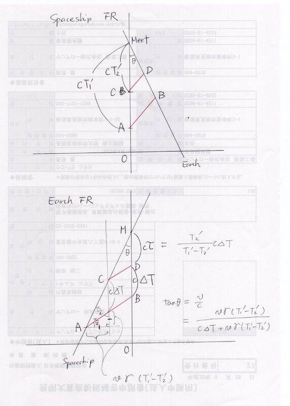

I don't know if is it correct this scheme, and it could help me to find the speed and how soon will the spaceship arrive on earth.
I cannot take meaning of "the time (of the spaceship) that is missing upon arrival, starting from the moment the message is sent. ". May I take ##T'##s as reading of spaceship clock when messages are sent, i.e. time of event A or C in the spaceship FR?
If I may take so
[tex]v=\frac{X_2-X_1}{T_2-T_1}[/tex]
[tex]T_2-T_1=\gamma(T_2'-T_1')[/tex]
[tex]\triangle T + \frac{X_2-X_1}{c}=T_2-T_1[/tex]
These equation give
[tex]\frac{v}{c}=\frac{1-Q}{1+Q}[/tex] where
[tex]Q=(\frac{\triangle T}{T_2'-T_1'})^2[/tex].
If values of ##(T_1,X_1)## or ##(T_2,X_2)## are given we get the arrival time.
I should appreciate it if you check these with your results.

By clarification in post #4 I would revise post #2
Please find attached space time diagrams of Spaceship FR and Earth FR.

Ok, I can rewrite all in terms of ##T'_2##, ##T'_1## and ##\Delta T##:
##t_1'=0##
##t_2'=T_1'-T_2'##
##t_3'=\frac{vT_1'}{1+v}##
##t_4'=T_1'-T_2'+\frac{vT_2'}{1+v}##
##\Delta t' = t_4'-t_3' = T_1'-T_2'+\frac{vT_2'}{1+v} - \frac{vT_1'}{1+v}=T_1'-T_2'+\frac{v}{1+v}(T_2'-T_1')=(\frac{v}{1+v}-1)(T_2'-T_1')##
Now remembering that
##\Delta T = \frac{\Delta t'}{\gamma}=(\frac{v}{1+v}-1)(T_2'-T_1')\sqrt{1-v^2}##
##\Delta T = (\frac{v}{1+v}-1)(T_2'-T_1')\sqrt{1-v^2}##
##\frac{\Delta T}{(T_2'-T_1')}=(\frac{v}{1+v}-1)\sqrt{1-v^2}##
##(\frac{\Delta T}{(T_2'-T_1')})^2=\frac{1-v^2}{(1+v)^2}##
Naming:
##Q=(\frac{\Delta T}{(T_2'-T_1')})^2##
We have:
##\frac{1-v^2}{1+v^2+2v} = Q##
##1-v^2=Q+Qv^2+2Qv##
##v_{1,2}=\frac{-Q\pm\sqrt{Q^2-(1+Q)(Q-1)}}{1+Q}##
##v_{1,2}=\frac{-Q\pm 1}{1+Q}##
##v_1 = \frac{-Q - 1}{1+Q}=-1##
##v_2 = \frac{-Q + 1}{1+Q}=\frac{1-Q}{1+Q}=\frac{(T_2'-T_1')^2-\Delta T^2}{(T_2'-T_1')^2+\Delta T^2}##
Why do I have two speeds? Is it all correct?
That all looks fine. ##v = -1## is clearly a spurious solution from solving a quadratic. We have ##v > 0##.
What about the remaining time until the ship reaches Earth?
1+v is canceled out both from denominator and numerator of the equation so
[tex]\frac{1-v}{1+v}=Q[/tex]
Likes Frostman and PeroK
PeroK said:
That all looks fine. ##v =1## is clearly a spurious solution from solving a quadratic. We have ##v > 0##.
##\tau_R=\frac{t_5'-t_4'}{\gamma}={(T_1'-T_1'+T_2'-\frac{vT_2'}{1+v})}{\sqrt{1-v^2}}##
##\tau_R=(T_2'-\frac{vT_2'}{1+v}){\sqrt{1-v^2}}##
##\tau_R=T_2'\frac{\sqrt{1-v}}{\sqrt{1+v}}##
##\tau_R=T_2'\frac{\Delta T^2}{(T_2'-T_1')^2}##
Is it ok?
Likes PeroK
Is it ok?
You have one mistake there. The last formula shouldn't have squares. Also, note that ##T'_1 > T'_2##.
And what happens if you try ##T'_1 - T'_2 = 2## and ##\Delta T = 1##? Do you get ##v = 0.6## and ##\tau_R = 3##?
1−v1+v=Q
Yes, thank you.
##Q=\frac{\Delta T^2}{(T_2'-T_1')^2}##
##\frac{\Delta T^2}{(T_2'-T_1')^2}=\frac{1-v}{1+v}##
##v=\frac{(T_2'-T_1')^2-\Delta T^2}{(T_2'-T_1')^2+\Delta T^2}##
Can you confirm?
Frostman said:
Can you confirm?
That is fine.
I get ##\tau_R = -3##, because in denominator I have ##-2## and numerator is ##6##. Have I forgotten any signs?
You used ##T'_2 - T'_1##, which (as I pointed out) is negative. And this became a problem when you took the square root.
You need to be more careful. Note that also, you used ##\frac{v}{1+v} - 1##. This simplies to: ##-\frac{1}{1+v}##, which is also negative.
You need to start noticing these things at this level of physics.
For example. That is not wrong. But, you should notice that:
$$(\frac{v}{1+v}-1)(T_2'-T_1') = \frac{T'_1 - T'_2}{1+v}$$
Which is better, in my opinion.
Likes Frostman
Okay, I understand. I'll make all the counts on my book and I'll repost the result, now with too many posts I lose the my thread.
It's just a sign as you pointed out.
The results are:
##v=\frac{(T_1'-T_2')^2-\Delta T^2}{(T_1'-T_2')^2+\Delta T^2}##
##\Delta \tau_R = T_2'\frac{\Delta T}{T_1' - T_2'}##
Thank you PeroK and anuttarasammyak. I always make a mistake in setting the problem and I take absurd paths when the easiest way is not there. I think I have to do more and more practice.
