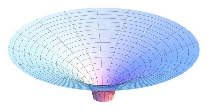

It tells you that the "space" defined by observers who are at rest with respect to the central body is not Euclidean; in fact it has the shape of the Flamm paraboloid, which is curved.
Note, however, that I carefully said "space" as defined by a particular family of observers (more technically, it is the "space" defined by spacelike hypersurfaces that are orthogonal to the worldlines of those observers). A different family of observers will define a different "space"; for example, the family of observers freely falling radially inward from rest at infinity will define a "space" that is flat, i.e., Euclidean.
Likes vanhees71 and Orodruin
For visual reference, this is the 2-dimensional Flamm paraboloid:
