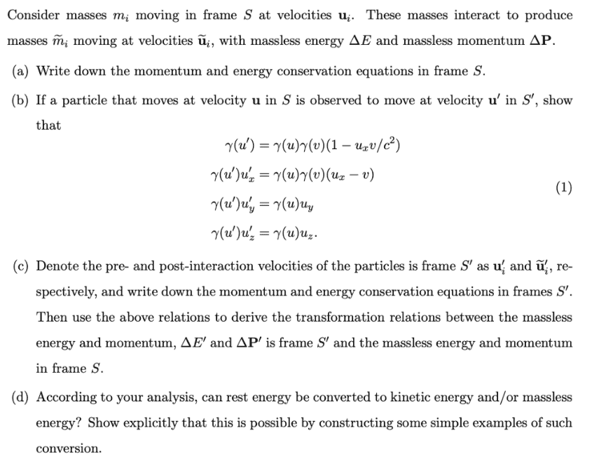

I can't seem to wrap my head around it: if an object is moving at speed v in frame S, and its observed to move at speed v' in S', what is the relationship?
You also need to define the speed of frame S' relative to frame S. Then (assuming you are using special relativity), you use the relativistic velocity addition formula, https://en.wikipedia.org/w/index.php?title=Velocity-addition_formula&oldid=96826716.
The case with 1 spatial dimension is simpler than the case with all three.
The relativistic velocity addition formula is different than just summing the velocities. Are you interested in just the formula, how it was derived, or some motivation as to why relativistic velocity addition is not just adding the velocities?
Likes thequantumcat
Yes this is SR. I am confused about the actual formula. In this case, what is v, u' and u to plug into the velocity addition formula. Moreover, what exactly is the frame at "rest"? The full question is actually:
This is homework, so you need to give it your best shot. Are you stuck on all of these questions?
There appears to be some missing explanation of the problem context (that you didn’t quote?). Specifically, it appears you are to assume S‘ is moving at v in the x direction per S.
Likes thequantumcat
I am, and no. I think if I can grasp the set up, then I'll be able to show the gamma's, and momentum and energy equations are fine.
So then is this correct:
S is at rest--inertial frame.
u is speed of object in that frame
S' is "moving observer" and its speed is v
u' is the speed of object in S' (i.e speed as seen by this frame)
In that case, the velocity formula would be:
u = (u' - v)/(1-(u'v/c^2)) ??
I am confused by this part really. Which quantity goes where?

In the non-relativistic limit we have ##u = u' + v##. Note that these are all velocities, not speeds.

Also, what do they mean by 'massless energy' and 'massless momentum'?
What does who mean by that?
Likes etotheipi
In the problem in post #3, it reads "these masses interact to produce masses ##\tilde{m}_i## moving at velocities ##\tilde{\mathbf{u}}_i## with massless energy ##\Delta E## and massless momentum ##\Delta \mathbf{P}##". Seems a bit odd to me... I don't quite know what that means... :wink:
Likes Ibix
I've never heard the term before, but I assume they mean energy/momentum taken away by massless particles.
Likes Ibix and etotheipi
...which is an image, which is why "find in page" only found your post. Sorry.
Me neither. Energy or momentum per unit mass, perhaps? Or kinetic energy ##(\gamma-1)mc^2##, although what massless momentum would be in that case I don't know.
Likes etotheipi
That makes more sense. Something like a nuclear fission process where you get energy carried away as radiation.
Likes etotheipi
