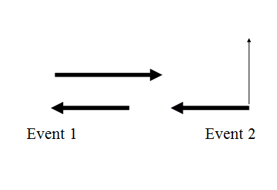

The rockets of the Goths and the Huns are each 1000 m long in their respective rest frame. The rockets pass each other, virtually touching, at relative speed of 0.8 c. The Huns have a laser cannon at the rear of their rocket that shoots a deadly laser beam at right angles to the motion. The captain of the Hun rocket wants to send a threatening message to the Goths by “firing a shot across their bow.” He tells his first mate, “The Goths rocket is length contracted to 600 m. Fire the laser cannon at the instant the nose of our rocket passes the tail of their rocket. The laser beam will cross 400 m in front of them.” But things are different from the Goths’perspective. The Goth captain muses, “The Huns’ rocket is length contracted to 600 m, 400 m shorter than our rocket. If they fire the laser cannon as their nose passes the tail of our rocket, the lethal laser blast will go right through our side.”The first mate on the Hun rocket fires as ordered. Does the laser beam blast the Goths or not? Resolve this paradox. Show that, when properly analyzed, the Goths and the Huns agree on the outcome. Your analysis should contain both quantitative calculations and written explanation.

okay i think i want to analyze using Lorentz transformation but i how should i start what is my event what is my stationary reference and what is my moving reference frame and i am guessing it has got something to do with the simultaneity of events does it?
EDIT:
i don't want to use an inertial reference frame anymore i decided to use the huns spaceship as the stationary reference frame and fixed the origin of coordinate system at their head. moving from the head to tail is considered positive hence the groths are moving relative to the coordinate system at +0.8 c. so the two events here are the crossing of the groths tail at huns head ie when groths tail is at x = 0 and the shooting of laser at x = 1000. the crossing event is at same time for both spaceships as x =0 and t =0. but for shooting event in huns reference frame it is at t = 0 . but for the groths it is at t' . where t' = ϒ(t - v x/c^2) where t = 0 , x = 1000 , v = +0.8 c and ϒ can be calculated to be 5/3. hence calculation got me t' = -4.44 x 10^-6 which means the laser was shot 1465.6m infront of the groths in the huns reference frame am i right
What did you get for x' at x = 1000, t = 0 from the Lorentz Transformation?

The coordinates of the event of the laser cannon firing are x = 1000, t = 0 (as reckoned from the huns frame of reference). What are the spatial coordinate x' of this same event as reckoned from the goth's frame of reference: ##x'=\gamma(x-vt)##? What does this equation give you for x'?
How does this compare with the coordinate of the tail of the goth's rocket x' = 0 and the nose of the goth's rocket x'=1000?

Well, here's how I would have approached it:
Event 1: x = 0, t = 0, x' = 0, t' = 0
Event 2: x = 1000, t = 0
$$x'=\gamma (x-vt)=\frac{5}{3}(1000)=1667$$
$$t'=\gamma (t-\frac{vx}{c^2})=\frac{5}{3}(-\frac{(1000)(0.8)}{c})=-4.44E-6$$
Nose of Goth ship is at x' = 1000, so cannon fired 667 m in front of nose of goth ship, 4.44E-6 seconds before tail of goth ship coincides with nose of hun ship.
Diagram of sequence of events as reckoned from huns frame:
Diagram of sequence of events as reckoned from goth's frame:

Just to add something. Here's how I would have begun to answer the question that was asked:
In the Hun frame, we know that the nose-to-tail event and the firing of the beam are simultaneous. We also know that the length contraction of the Goth ship is a valid measurement (in the Hun frame). We, therefore, have all the information in the Hun frame to conclude that the warning shot misses the Goth ship.
As this is a physical result, it must be observed in all reference frames.
Now, to resolve the paradox, we analyse the events in the Goth frame, and show that the shot also misses in that frame (which it inevitably must) ...
