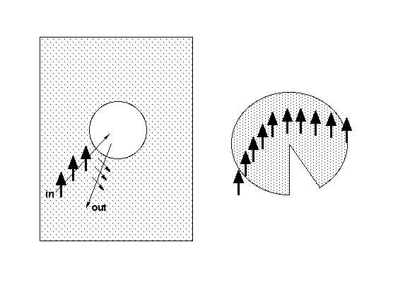

A while ago we had a topic here about a picture you sometimes encounter when discussing precession, like
Those can be a bit deceiving, because it suggests that precession is purely a geometric phenomenon. As Orodruin indicates, it isn't.
Likes tomdodd4598
