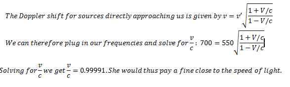

Shown below
I know I probably did something wrong...but what?
Solving for v went wrong. As you did not provide steps of this, I cannot tell what exactly.
Ahhhh! I subtracted by 550 by accident. However, is my procedure correct?

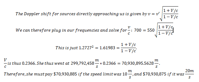

How does this look?
Looks good.
Certainly the fine for the red light would have been cheaper.
